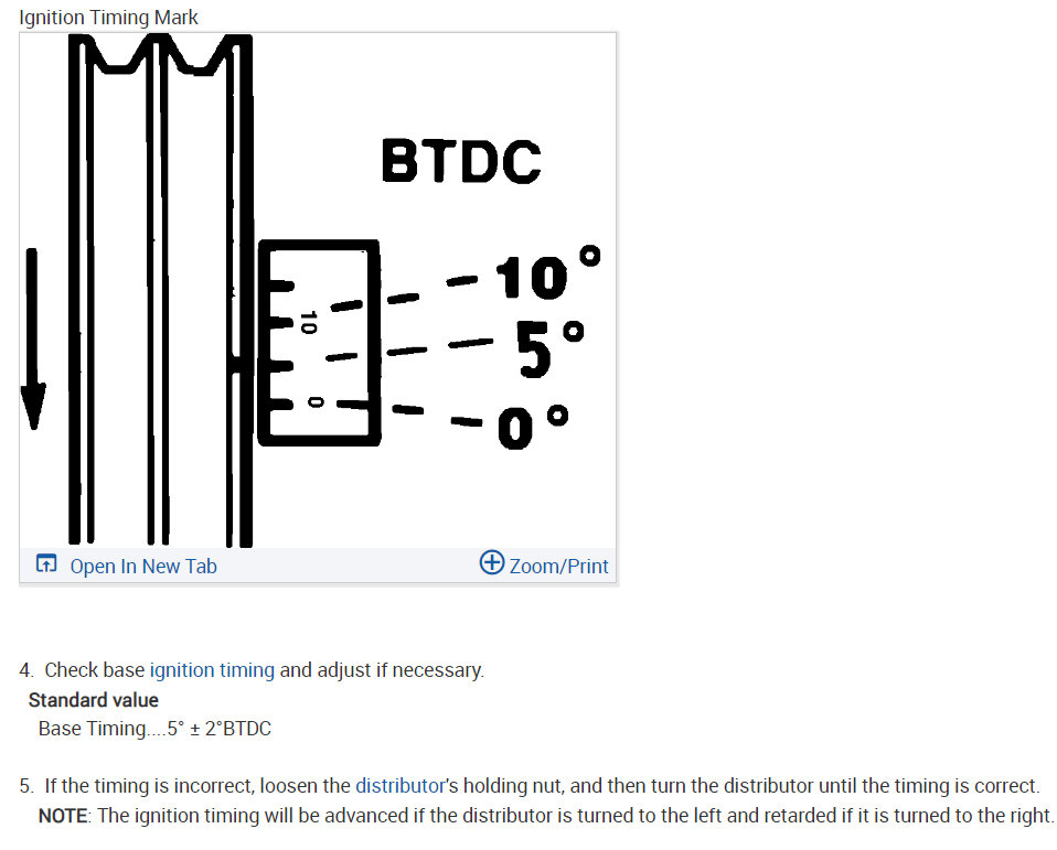

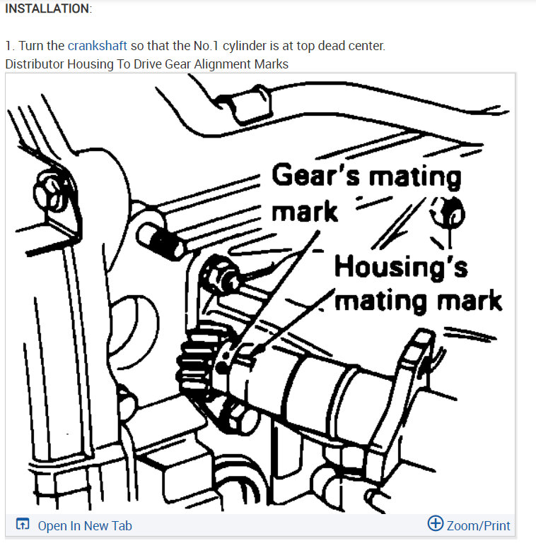

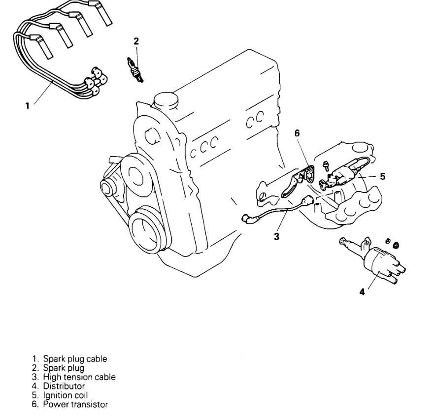

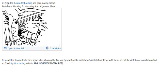

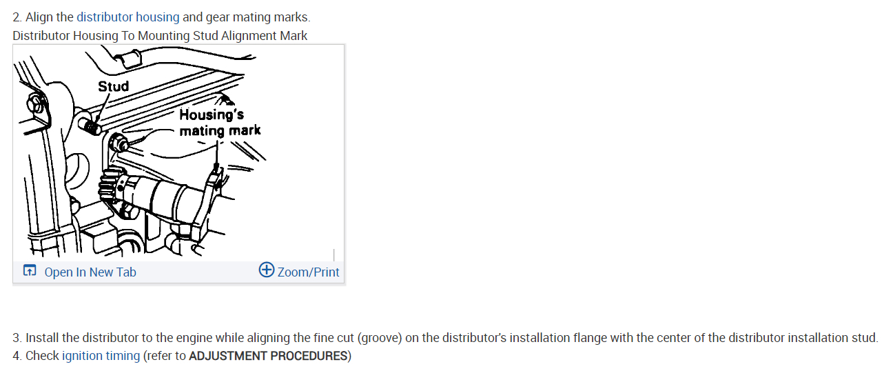

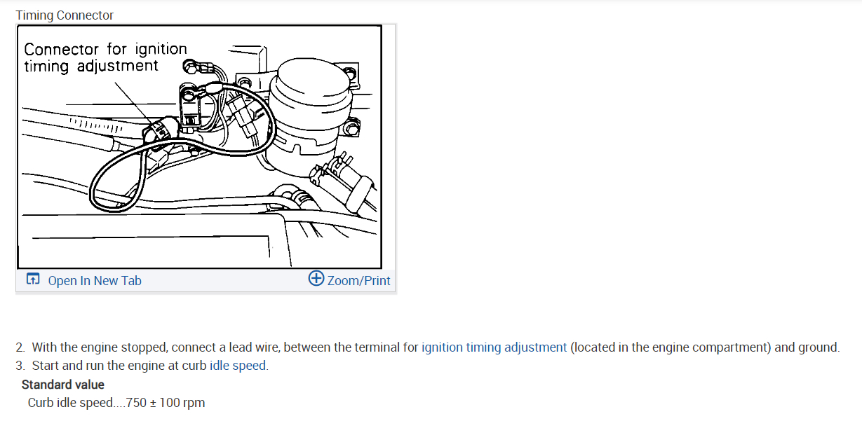

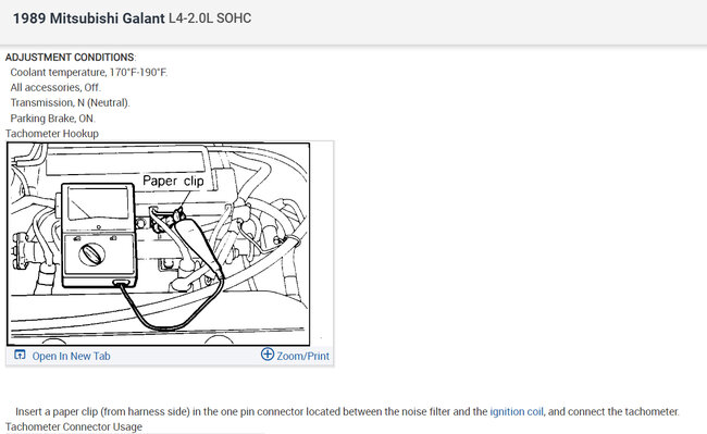

I loose the timing because i pulled out the distributor assembly then i pulled the cylinder head and the cam shaft. the reason is, the spark plug got broken cut into 2 piece. is it possible to show me the diagram for this. they told me it's a cyclone engine
Dec 6, 2007 at 8:07 PM
JWALTH02
  • 180 POSTS

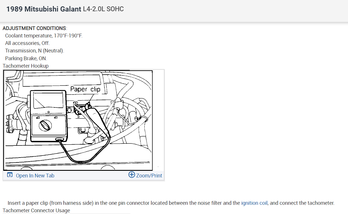

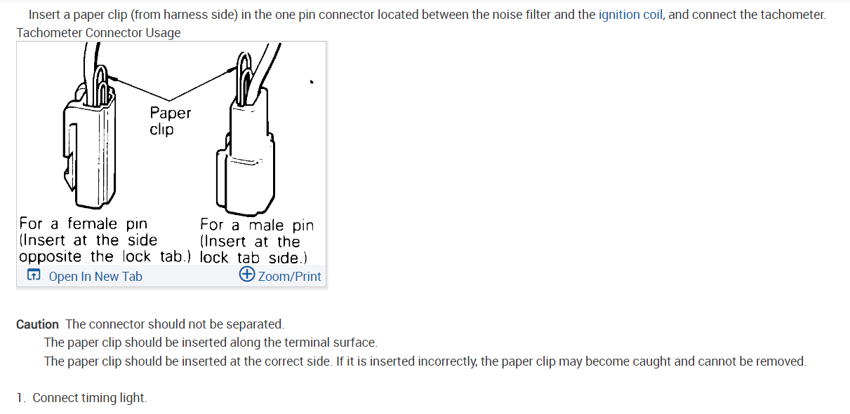

Here is how to install the ignition distributor and how to set the ignition timing. Check out the images (below). Let us know if you need anything else.
