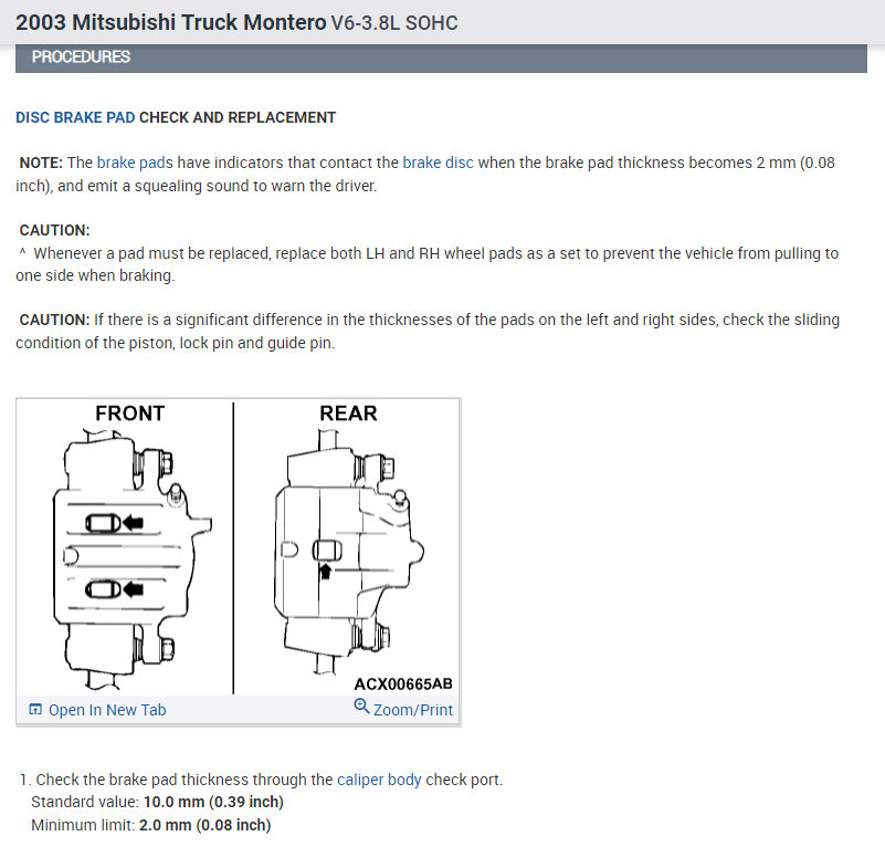

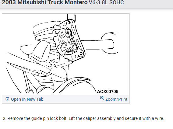

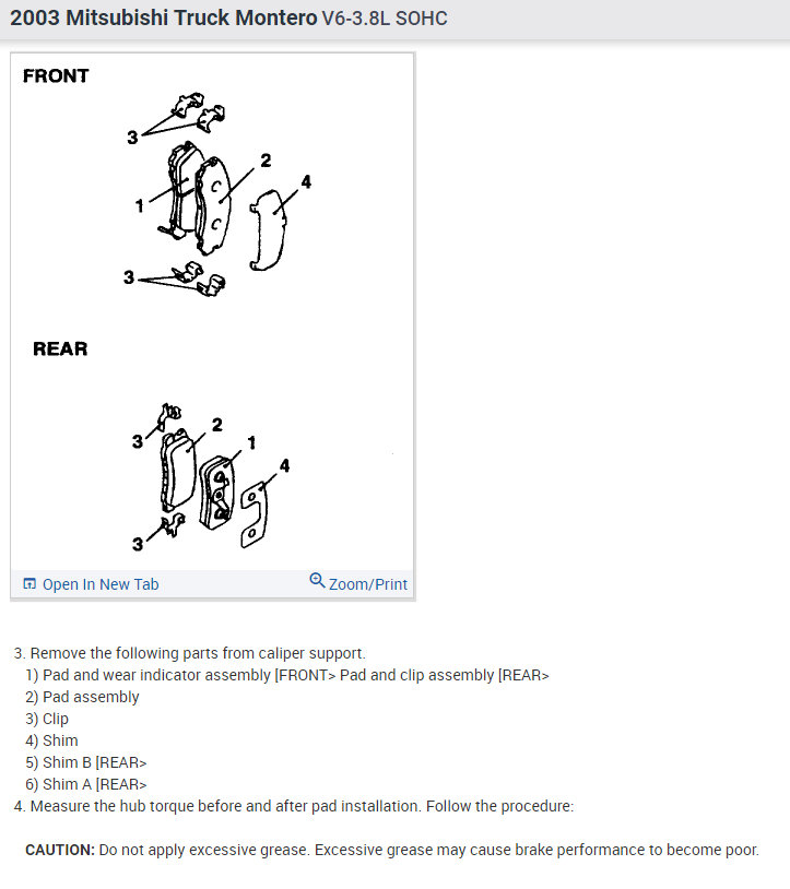

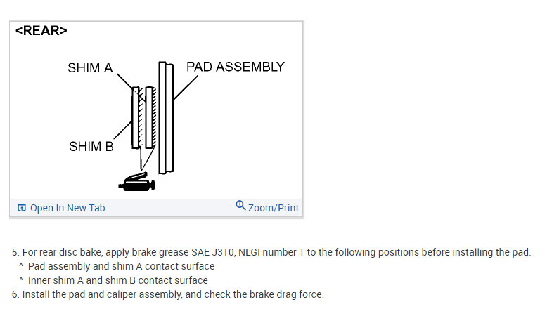

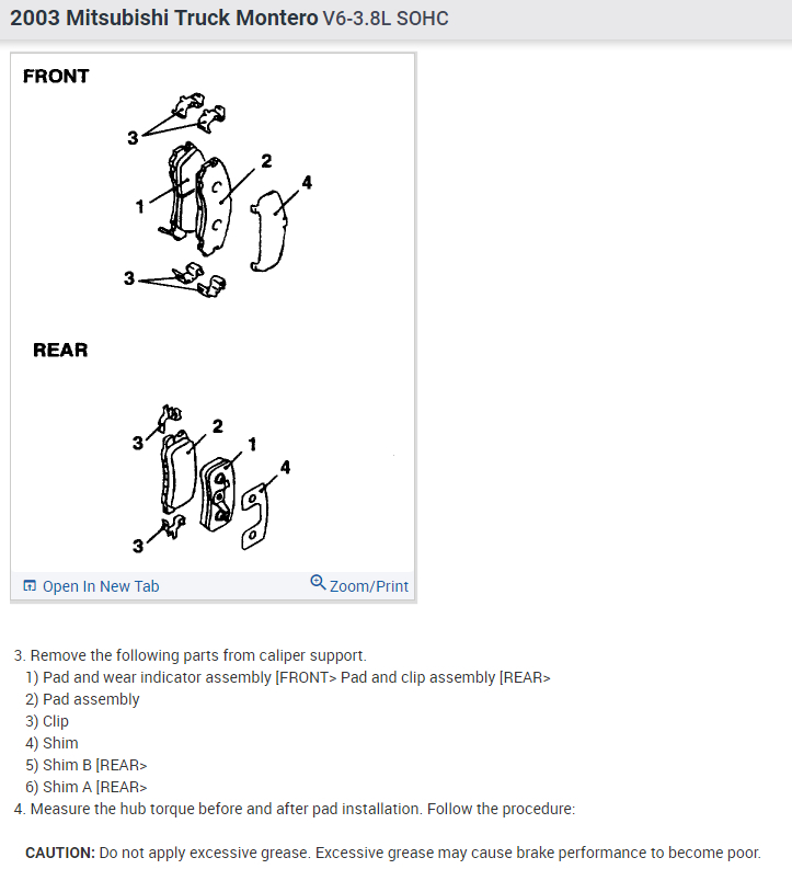

It sounds like an issue with the brake pads. It is possible that the anti-rattle clips for the pads got loose and that is the noise you are hearing. It could be just rubbing against the rotor.
Check the brake pads and see if those clips are loose. I have attached diagrams that shows what the clips looks like (see below).
Please note that if your brake rotors were wrapped, you would have felt vibration/pulsation while braking.
