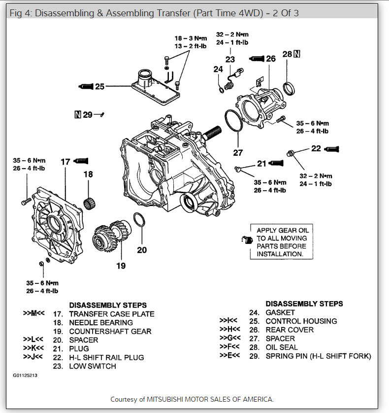

This sounds like a retainer clip broke or the 2wd to 4wd shift fork is worn
Aug 17, 2019 at 9:41 AM
GRATIOT67
The c/d four wheel drive light is flashing and the car wont come out of four wheel drive what is the problem?
Aug 17, 2019 at 9:42 AM (Merged)
KHLOW2008
  • 41,814 POSTS

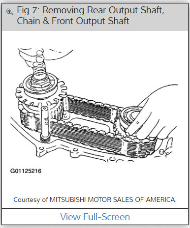

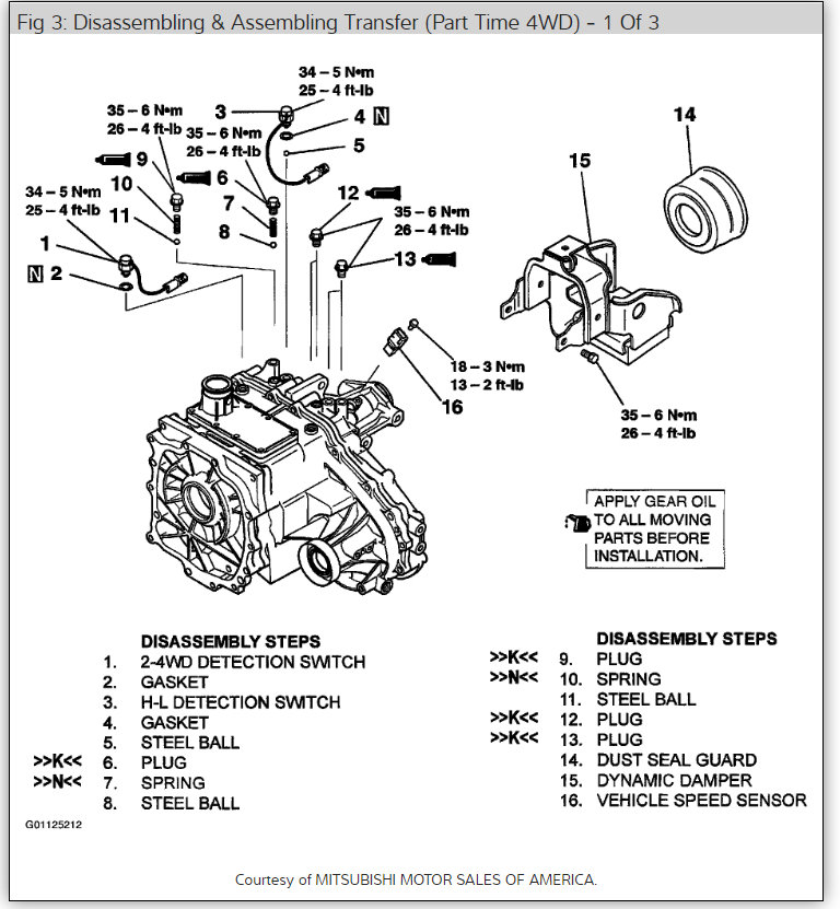

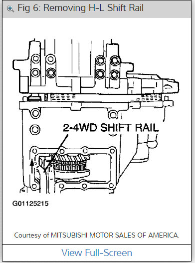

This sounds like a retainer clip broke or the 2wd to 4wd shift fork is worn here are diagrams to help you see what you are in for when doing the job. Check out the diagrams (Below). Let us know what happens and please upload pictures or videos of the problem.
