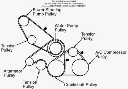

Have the part, just don't have a diagram on how the belt goea on? Hoping you woul be able to email me a picture so I know how to put the belt on. Thanks Steve
Jan 16, 2010 at 3:51 AM
MERLIN2021
  • 17,250 POSTS

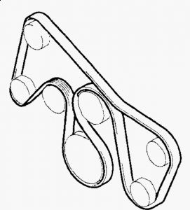

Montero has one belt shown first, Montero Sport has three shown at bottom. If you only have two belts then more then likely you don't have AC so you would not have an AC belt so the one with three belts would just not have the third belt.
