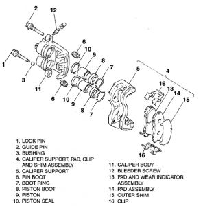

i need a diagram of how to assemble the brake pads for a montero sport 02 i dont know where the clips go

https://images.2carpros.com/forum/automotive_pictures/261618_Noname_2582.jpg
