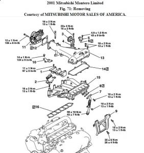

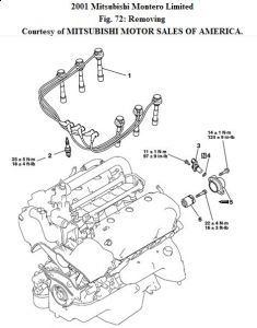

Engine Mechanical problem
2001 Mitsubishi Montero 6 cyl Two Wheel Drive Automatic
How do I do a tune up myself? Like change the spark plugs?
Jun 8, 2009 at 4:11 AM
KHLOW2008
  • 41,814 POSTS
Hi b173airborne, Thank you for the donation. Vehicles nowdays are made with minimal tuning requirements except for the spark plugs, oil and filter changes. Most things are controlled by the PCM and requires no adjustment or unadjustable. However for your model, replacement of the spark plugs requires the intake manifold to be removed to gain access to 3 of the plugs. Attached is a diagram for the removal of the ignition components, do only the necessary and follow the numered sequence.
https://images.2carpros.com/forum/automotive_pictures/192750_ManifoldIntake01Montero_1.jpg
https://images.2carpros.com/forum/automotive_pictures/192750_IgnitionComp01Montero_1.jpg

BNA1DEW
Could I get the actual file for the removal of the ignition system? When I copy and paste and enlarge it is very blurry. I am trying to see how difficult is would be to do my own tune up.
