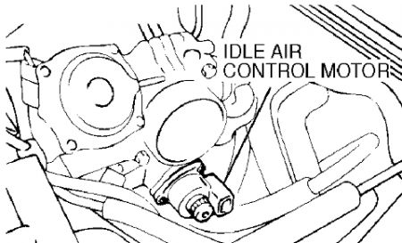

Hello dannyfromny Check the idle air motor.
https://images.2carpros.com/forum/automotive_pictures/46384_idle_motor_2.jpg
Carbon and coking build up could be the problem if not Have it tested,remove the unit, with the wires connected turn the key to the "on" position without starting the engine, it should move in or out. Get back with what you have found so we can continue.

Perfect! I took the idle motor off and tested it and it did move outwards, and it was really dirty, I cleaned the unit and the housing really good with break pad cleaner (spray) and a towel then I let it dry for 3 hours (just to make sure no chemicals were left behind) I put everything back in place and MAGIC the car turned right on, I couldn't wait to go and test the car at stop signs, going really fast and fully stopping and the engine really quiet stayed on AT ALL TIMES. Thank you so much something so simple drove me insane, God Bless
