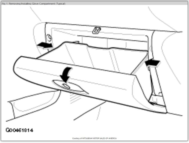

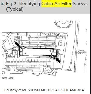

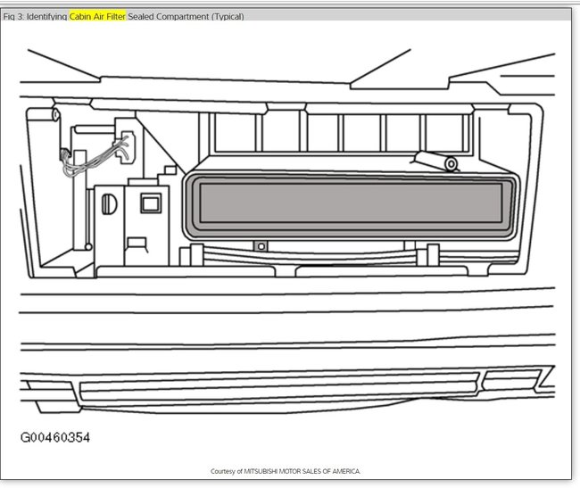

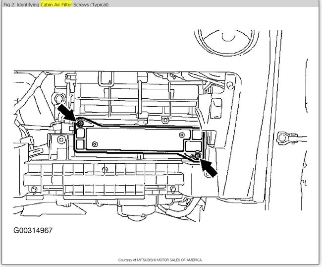

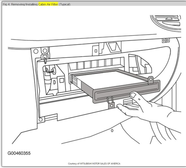

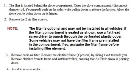

I would like to know where is the cabin air filter located. Thanks
Jun 11, 2008 at 2:46 PM
  • 55,423 POSTS
Here is a guide to walk you through the steps and diagrams (below) that will show you how to replace the cabin air filter in a car.
https://www.2carpros.com/how_to/change_cabin_filter.htm
The images below are for your vehicle, looks to be behind the glove box

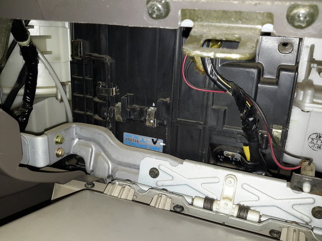

Does my car listed above have a cabin air filter and if so, where is it located? I just dismantled the glovebox and not sure how to reach it.

looks as if your model does not use one, i had a look on Mitchel 1 data base and it shows a filter if used behind the glove box as shown in the picture below, but just to make sure please advise engine and trim level on your car, so i can do an exact search.
Jan 30, 2017 at 5:22 PM (Merged)
ENONGENE LOUIS EJOLLE
It is the 2001 Mitsubishi Montero Sports, V6 3.0, rear transmission, XLS model.
MHPAUTOS
  • 31,937 POSTS
I put your car details in the data base and it came up with no result, so i would say that your vehicle is not fitted with a cabin filter.

It does not have one.
