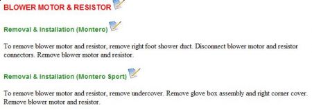

How do i change the blow resistor for Mitsubishi Montero?

https://images.2carpros.com/forum/automotive_pictures/261618_Noname_1103.jpg
