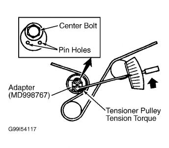

2000 Mitsubishi Montero 6 cyl Two Wheel Drive Automatic
how do you set the auto-tensioner and tension pully (essentric) adjustment. the auto tensioner looks like it has a plunger that i can't collapse and the pully is on a swing arm and i need to know what degree to set the essentric...3.0L single overhead cam.

Use a vise to collapse tensioner (slowly) and then hold in place with a small drill bit (must be hard). Line up marks and install belt.Temporarily tighten eccentric against belt with tensioner installed. Turn crank 1/4 turn counterclockwise then 1/4 turn clockwise. Be sure marks still ine up.With pins at bottom of ecentric, tighten ececntric to 39 inch lbs against belt (requires special socket)
https://images.2carpros.com/forum/automotive_pictures/1639_mitsu_1.jpg
then tighten lock bolt to 18 ft lbs.remove pin from tensioner and rotate crank 2 full revolutions and be sure marks still ine up
