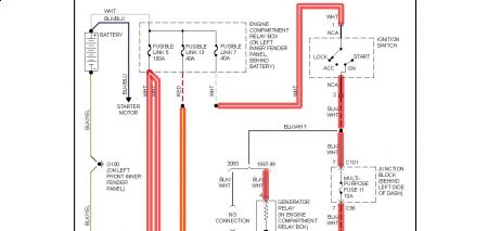

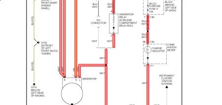

Vehicle wasn't charging. Tested with a multi-meter. Replaced the alternater and belt. Vehicle is still not charging. I have found nothing else obvious. What am I missing here?
Dec 20, 2009 at 10:22 AM
  • 75,992 POSTS
Check all the fusible links and fuse to include the generator relay-See below
