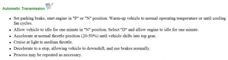

I recently had a sensor replaced on my 1996 Mitsubishi Montero. When I went to go smog it, I was told it would not pass because the computer had not reset itself and was advised to drive it for about 60 miles, which I did. 500+ miles later, the computer still has not reset - I am told it has completed some of the test, but not all. Any idea on how I can get it to complete the cycle of tests?

https://images.2carpros.com/forum/automotive_pictures/261618_Noname_2526.jpg

Thank you for the response. I went back to the smog place and they said only 4 of 7 tests are complete. Should I be doing these in the order listed? Should I start from scratch? By any chance, do you know if how long I have to cruise for? Any assistance is greatly appreciated. thank you!

doing what in what order listed?
my previous post had the steps to follow in order to reset the computer correctly..
