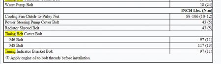

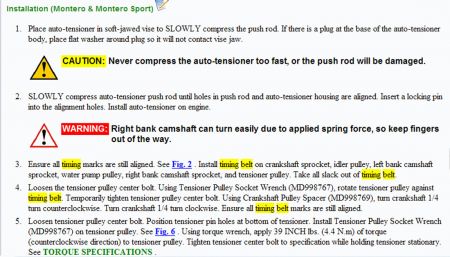

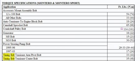

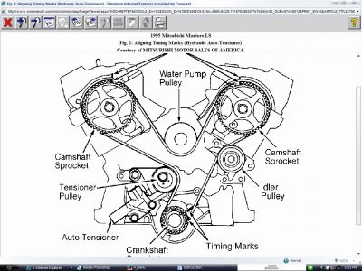

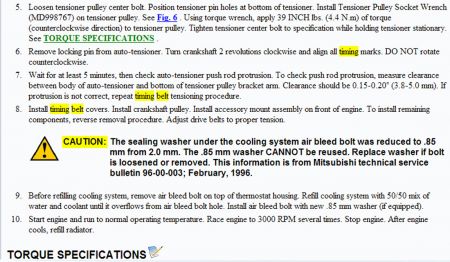

i am installing a timing belt,
the belt is alredy on but i do not know how to adjust the tensioners it has 2, can you help me?
(i can't find a repair manual anywhere)
Apr 28, 2008 at 9:23 AM
MERLIN2021
  • 17,250 POSTS
I'll do what I can, I am not a Mits mechanic but here's the scoop, the tensioner on the left when looking from the front of the engine, is the tensioner, the oposite one is an idler...here are you instructions! Good luck!

What software is that diagram from? Or is that just from the shop manual?
Sep 14, 2009 at 4:50 AM
MERLIN2021
  • 17,250 POSTS
Mitchell on Demand, follow the link on the page and I think it's $10.00 U.S.
