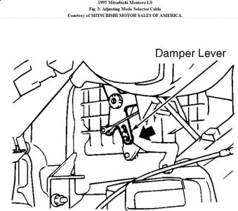

I have had the typical altenator/oil leak issue repaired and have a new, known-good battery and alternator installed, now the intstrument cluster lights, center guage 'pod' back-lights are out, also, the climate controls are 'stuck' on defrost (heat and fan control works fine though) The fuses are good, and the transmission position indicator lights work, clock lights up and dims when headlights are on - but, no dash/pod lights(?!)

I have checked all of the usual starting points, the tail lights work, the fuses are good, The dash, pod lights do not back-light at all, and when I turn on the headlights the gear (automatic) position lights go out completely. Other than that the guages work fine. The reason I suspect a module or relay is the HAVC controls are 'stuck' on defrost - a default mode I'm guessing.
Anybody run into this? Can you tell me what/where the problem component could be?

It could be due to a bad ground connections around the dash area. Was any repairs carried out prior to this happening?

It may be a ground, however, does that explain the HVAC stuck in defrost (regardless of the dial position)? - I know of no work done except the altenator replaced...

From our database, the mode selsctor is manual and uses a cable to control the various positions. There is a possibility you have more than one problem. Check if the cable is detached from its position.
https://images.2carpros.com/forum/automotive_pictures/192750_ModeSelsctor95MonteroFig03_1.jpg
The dash and taillights uses the same circuit so that rules out power supply or switch problem. If your vehicle is equipped with dimmer control, check if it is adjusted correctly.
