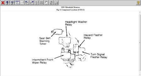

My turnsignals are not working .......the fuse is ok...
I bought the flasher but can't find the Location .....
where is it ?????

Its behind left side of dash see below-
https://images.2carpros.com/forum/automotive_pictures/12900_flasher_41.jpg
