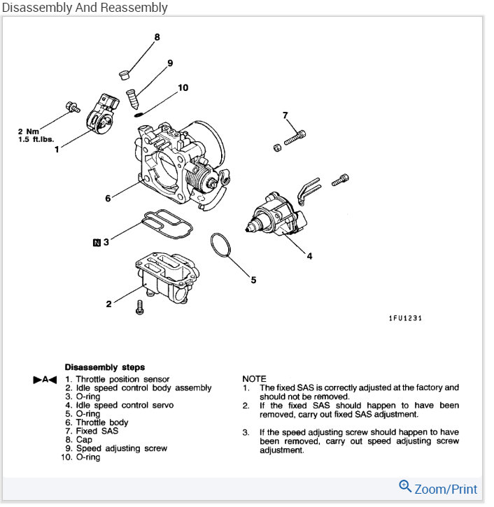

Diagnostic code showed throttle position sensor. I checked the wiring and nothing seems to be lose. Where is it located at and how do I replace it?
Jan 11, 2010 at 9:14 PM
OBXAUTOMEDIC
  • 3,711 POSTS

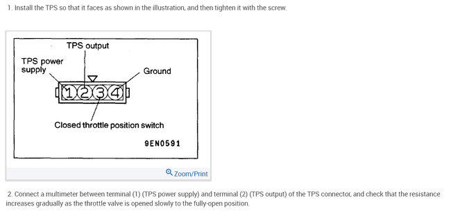

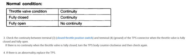

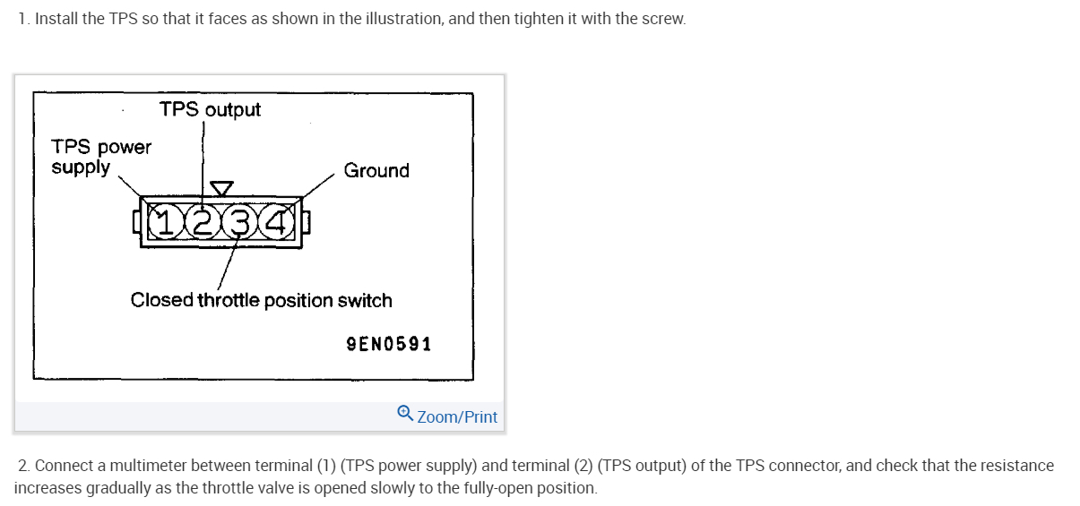

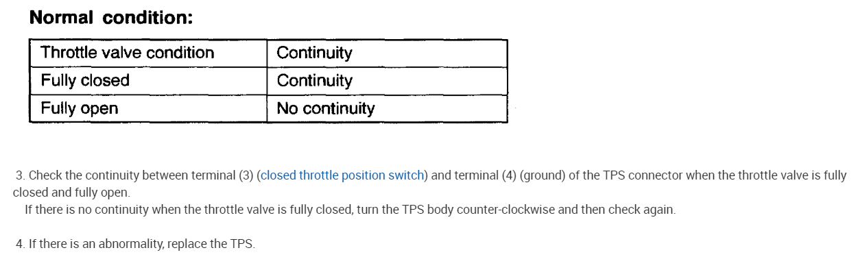

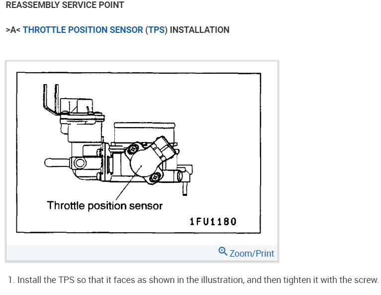

It is located on the side of the throttle body. And is usually mounted with 2 bolts.
Here is a diagrams below to help you caibitate the sensor a minor adjustment is needed.
Be sure to service the throttle bore when doing the repair.
