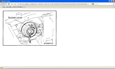

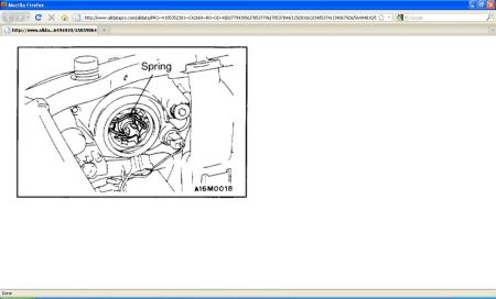

How do you change the headlight bulbs in a Mitsubshi Mirage 2000

BULB REPLACEMENT 1. Disconnect the connector. 2. Remove the socket cover. 3. Unhook the spring securing the bulb, and then remove the bulb. CAUTION: Do not touch the surface of the bulb with hands or dirty gloves as the bulb may pop after a short time. If the surface does become dirty, clean it with alcohol, and let it dry thoroughly before installing. There you go.
