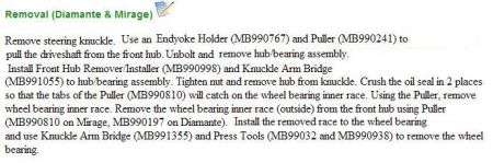

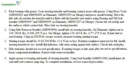

How do you get the front hub bearing out of the hub for replacement. I have the inner snap retaining ring out already. Does it have to come out with a puller?
Jun 26, 2009 at 4:43 AM
BLUELIGHTNIN6
  • 16,542 POSTS
https://images.2carpros.com/forum/automotive_pictures/261618_Noname_588.jpg
https://images.2carpros.com/forum/automotive_pictures/261618_Noname2_153.jpg
