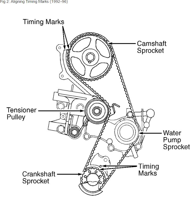

reset camshaft timing in motor
1997 MITSUBISHI MIRAGE
180,000 MILES • 4 CYL • FWD • MANUAL
MISSYBOO21
i need to know the timing marks on the pulleys where the timing belt goes they got moved and now car wont start
Feb 23, 2010 at 9:37 AM

https://images.2carpros.com/forum/automotive_pictures/261618_Graphic_352.jpg
Feb 23, 2010 at 3:07 PM

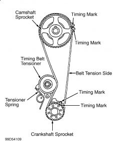

DANIELJBENDER
On the lower gear I aligned the circle on the gear with one at approximately 12 o'clock or slightly later, on the top it currently is around 3 o'clock and the rooter points to 11 o'clock not 4 o'clock where piston 1 is. The books I look suggest the top gear at around 11 oclock. Can you straighten me out so I can put the timing belt back on thankyou so very much dan bender
Jul 18, 2019 at 12:53 PM (Merged)
KHLOW2008
  • 41,814 POSTS
Refer to diagram

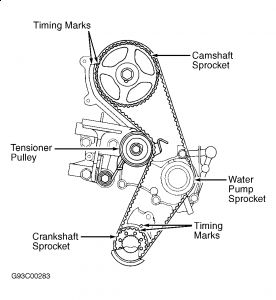

SNAKEAE86EK
Engine Mechanical problem
1995 Mitsubishi Mirage 4 cyl Front Wheel Drive Manual
i wanna know the timing marks for my 1995 mitsubishi mirage ls 1.8 engine
BLUELIGHTNIN6
  • 16,542 POSTS
https://images.2carpros.com/forum/automotive_pictures/261618_Graphic_198.jpg
