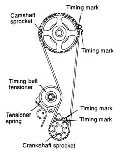

hi i was hoping you could provide me a timing diagram as i replaced the water pump and the timing belt moved and I dont know where goes

Hello Diagram is below for the 1.5L engine. If your engine size is anything other than the 1.5L, please list it and let me know. ((1995-00 1.5L engine))
https://images.2carpros.com/forum/automotive_pictures/261618_0900c15280037da1_1.jpg
