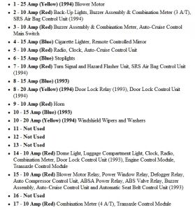

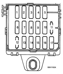

I have just bought a 95 Mitsubishi Mirage 2 door coupe. I am trying to figure out what fuse goes to what and what size fuse to put into the empty slots? there is no cover where i suspect the diagram most likely is! any help would be greatly appreciated.

fuse panel is beneath instrument panel to the left of the steering column
https://images.2carpros.com/forum/automotive_pictures/261618_Graphic_502.jpg
https://images.2carpros.com/forum/automotive_pictures/261618_Noname_2163.jpg
