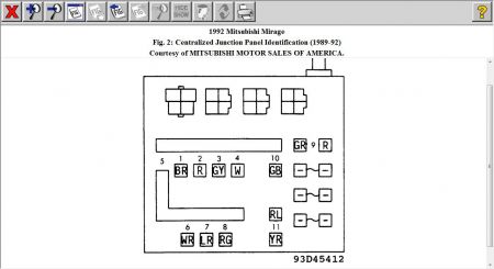

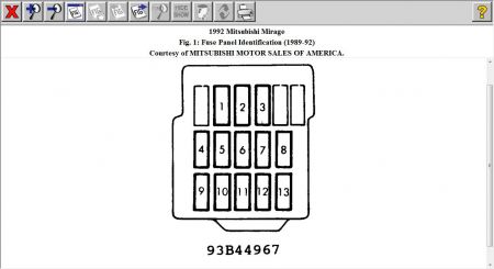

Electrical problem
1992 Mitsubishi Mirage 4 cyl Two Wheel Drive Automatic
THE DESCRIPTION ON THE FUSE BOX INSIDE THE CAR IS IN CHINEESE OR JAPANEESE. cAN ANYONE SEND ME A DIAGRAM WITH THE ENGLISH TRANSLATION

https://images.2carpros.com/forum/automotive_pictures/12900_f1_26.jpg
FUSE PANEL IDENTIFICATION (1989-92) Fig. 1: Fuse Panel Identification (1989-92) Courtesy of MITSUBISHI MOTOR SALES OF AMERICA. 1 - 15 Amp Wipers, Washers 2 - 10 Amp Gauges, Warning/Indicator Lights, Clutch Switch (M/T) 3 - 10 Amp Radio, Clock 4 - 10 Amp 4-Speed Automatic Transmission, A/T Control Unit, Overdrive Switch, Inhibitor Switch, Auto-Cruise Control Unit 5 - 10 Amp Back-Up Lights, Hazard Warning Lights, Inhibitor Switch (A/T), 3-Speed A/T Control Unit 6 - 10 Amp Horn Relay, Headlight Relay 7 - 15 Amp Cigarette Lighter, Remote Mirror 8 - 10 Amp Dome Light, Luggage Compartment Light, Clock, Radio, MPI, 4 A/T Control Units, Door-Ajar Warning Light, Automatic Seat Belt Control Unit, Seat Belt Warning Buzzer, Key Reminder Switch 9 - 10 Amp Power Window Relay, Defogger, Heater Relay, Blower Switch, Auto Compressor Control Unit 10 - 20 Amp Heater Relay 11 - 15 Amp Automatic Seat Belt (1989), Door Lock Control Unit, Relay 12 - 15 Amp Stoplight
https://images.2carpros.com/forum/automotive_pictures/12900_f3_12.jpg
1 - 20 Amp MPI Circuit 2 - 40 Amp Headlight Circuit 3 - 30 Amp (40 Amp on 1.6L Engine) Radiator Fan Motor Circuit 4 - 40 Amp Ignition Circuit 5 - 80 Amp Alternator Circuit, Fusible Link 6, 7 & 8 6 - 40 Amp Multi-Purpose Fuse 7 - 30 Amp Power Window Circuit 8 - 30 Amp Defogger Circuit 9 - 15 Amp Taillight Circuit 10 - 10 Amp High Beam Circuit 11 - 10 Amp Hazard Warning Light Circuit
