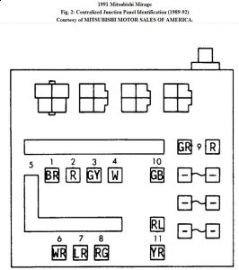

My daughter recently installed a new CD player in her cal. Afterward she noticed she had no dash lights and her rear lights were not lit when front lights were on. Brake lights worked fine.

Hi Shers33, Thank you for the donation. The taillight and interior illuminations light fuse is blown. Replace the fuse with one of the same amperage and retest, If the fuse blows again, the CD wiring has to be checked for possible installation faults. Fuse # 9 in Relay Box.
https://images.2carpros.com/forum/automotive_pictures/192750_FuseBox91MirageFig02_1.jpg
