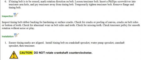

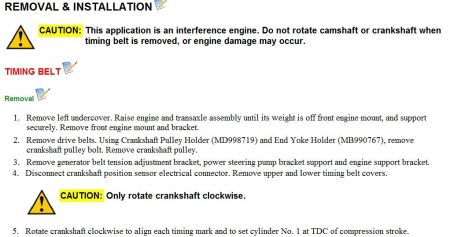

The timing belt needs to be replaced on my Lancer. However the crankshaft nut is very tight. Is there a special tool or trick to removing this nut. I have changed timing belts before on a 2004 Hyundai
