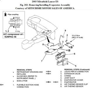

where is the aircon drip hose?

Hi caviddain1, Thank you for the donation. The drain hose is attached to lower part of evaporator housing ( item # 6 ) and goes out though the firewall on passenger side.
