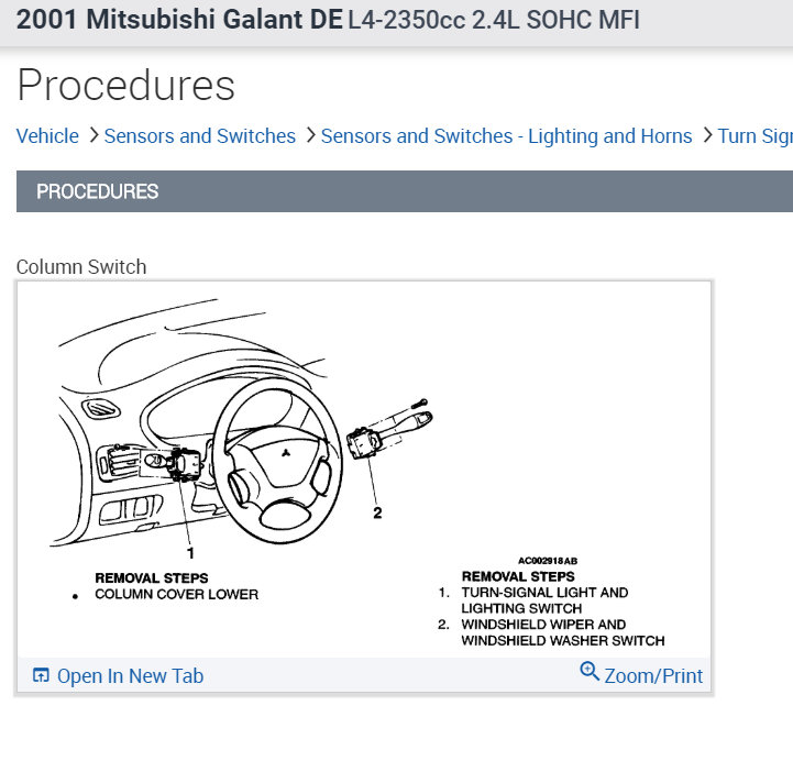

Do i have to remove the steering wheel to replace the turn signal switch or can i get to it by removing the steering column covers?
Feb 18, 2021 at 4:39 AM (Merged)
GUAIRDEAN
No, it's not necessary to remove the steering wheel. Remove the three screws underneath the cover, unclip the switch (one at the top and one at the bottom) with your fingers and pull it out. Insert the new switch and replace the covers. Leave the steering column adjusting lever down to facilitate moving the column when removing the covers.

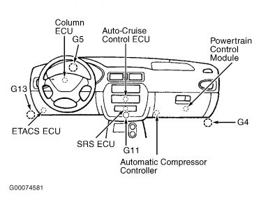

TOLBERTRATLIFF
Turn signals and hazard flashers stopped working. I replaced the headlight, turn signal switch and still no lights. Is there a relay? It's my step-daughters car and her Dad can't find owners manual. I'm an injured police officer and I would donate but don't have money right now. Please help!

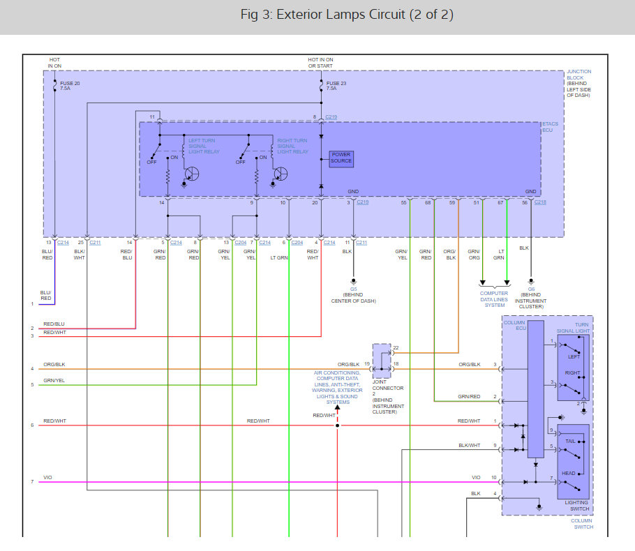

DOCFIXIT
  • 18,828 POSTS
Flashing control is by the ETACS ECU are dash indicators out also? see diagram for location
https://images.2carpros.com/forum/automotive_pictures/198357_Graphic_496.jpg
This guide can help us fix it https://www.2carpros.com/articles/turn-signals-not-working-blinker Please run down this guide and report back.
TOLBERTRATLIFF
Yes, dash indicators are out also.

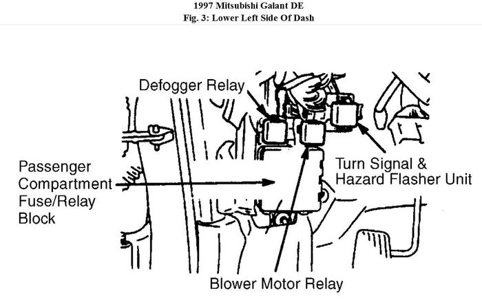

looking for the turn signal flasher on 97 galant. Looked under dash, drivers side, all around fuse panel and can't seem to find it. There are 2 plastic gray colored relays beside fuse panel that won't come out. Is one of them the flasher or is it somewhere else?
KHLOW2008
  • 41,814 POSTS
The turn signal flasher is located at lower left side of dash. Check out the diagrams (Below). Please let us know if you need anything else to get the problem fixed.

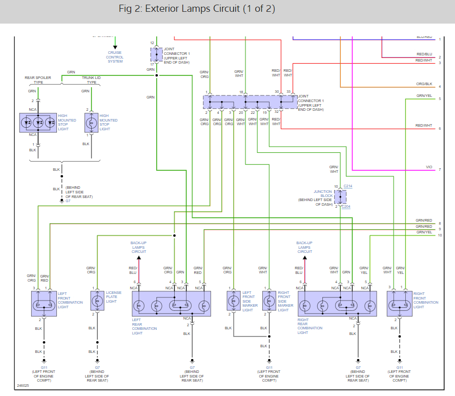

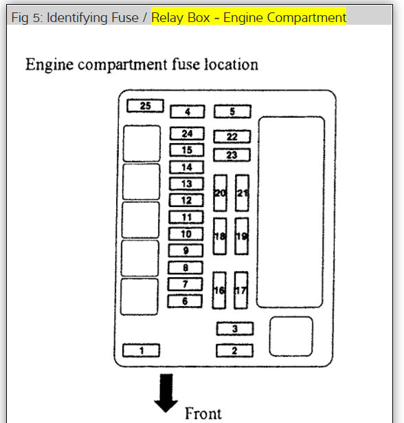

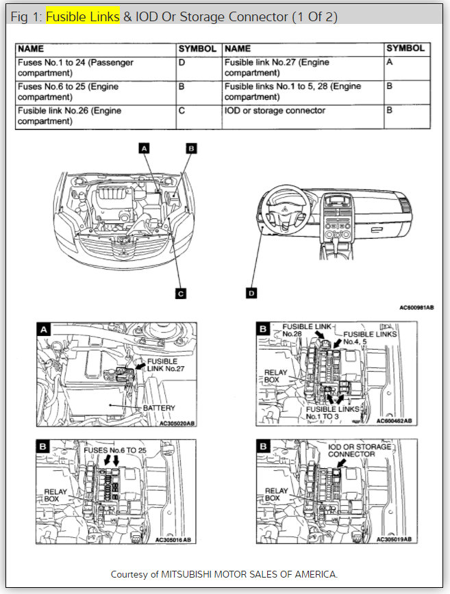

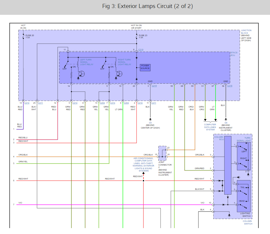

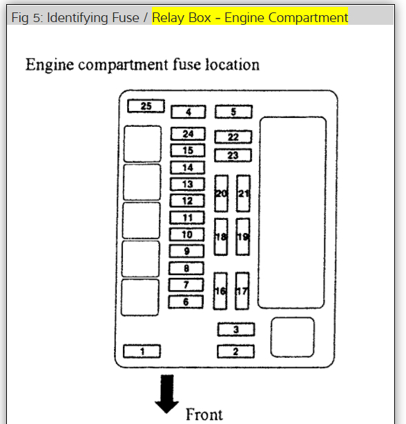

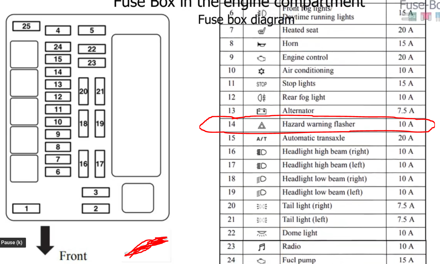

DAVIDECHEN

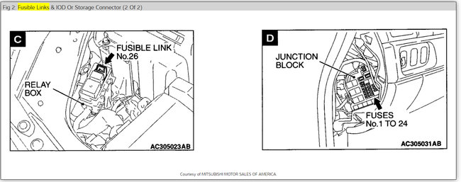

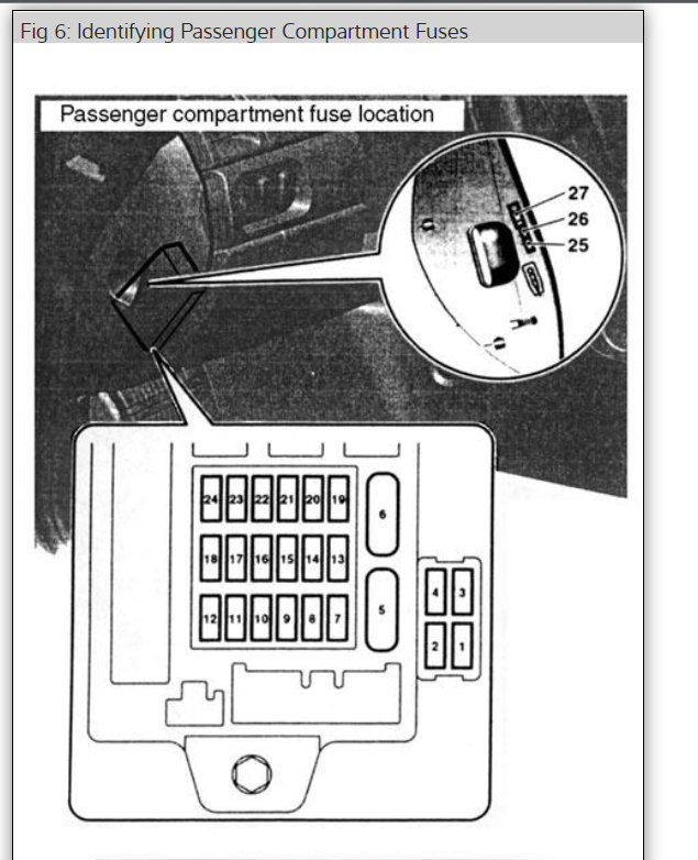

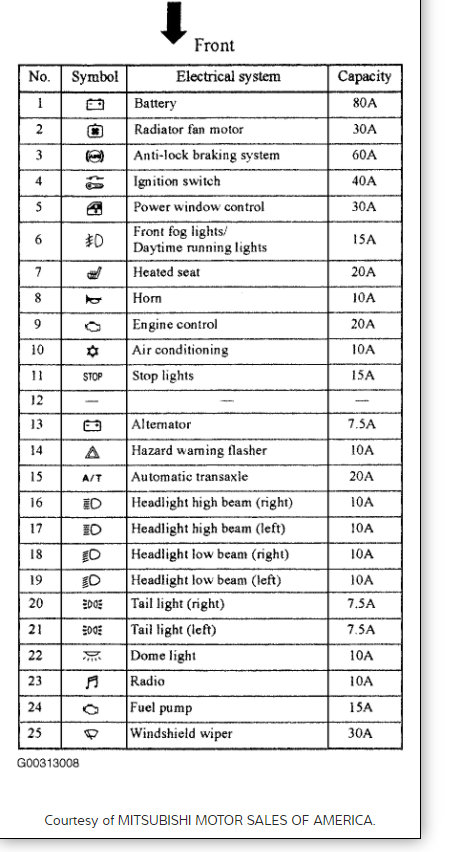

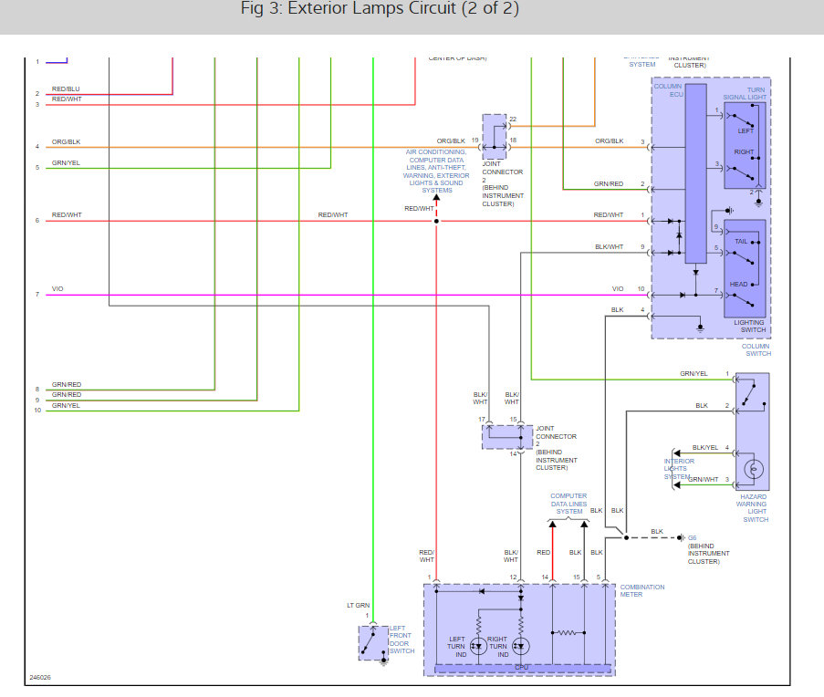

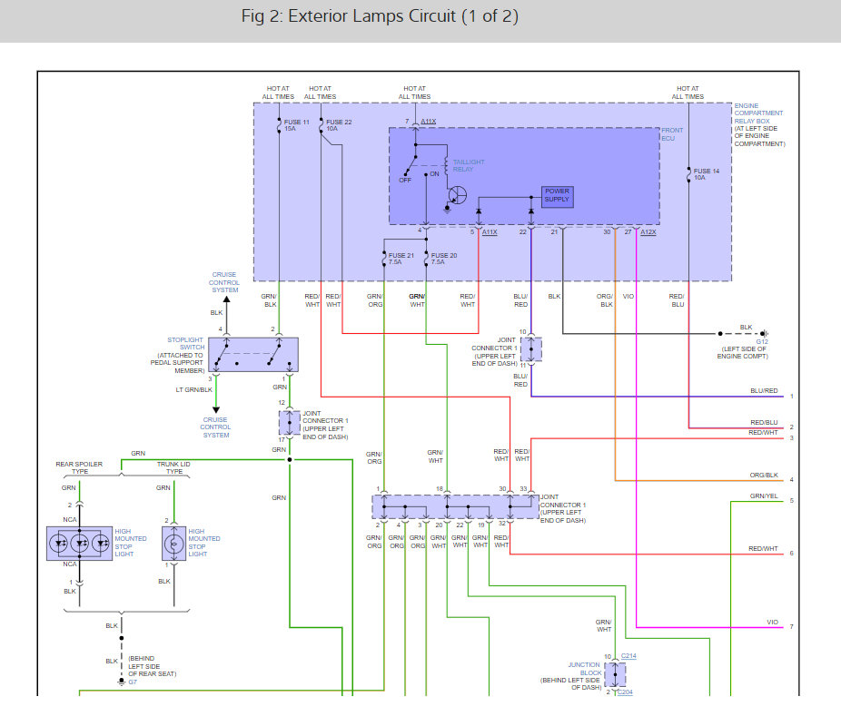

my blinkers and hazard signals we are not working on my 2006 Mitsubishi Galant ES. I replaced the 10A fuse for the hazards that is located in the fuse box under the hood by the driver side engine compartment.
Sep 22, 2022 at 9:16 AM
  • 55,433 POSTS
There are 7 fuses that run the blinker system. here is a wiring diagram for the blinkers and hazard lights so you can see how the system works and which fuses to check with a guide to show you how to check for power at the fuses.
Check out the images (below). Please let us know what you find. We are interested to see what it is.
