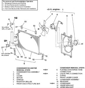

how do i replace the old condenser

https://images.2carpros.com/forum/automotive_pictures/261618_Noname_2130.jpg
