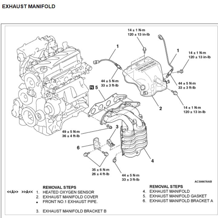

are there two sensors for my 05 Galant catalytic converter and should I replace them before replacing the converter...my engine light is on and I was told it could be my converter.

You should replace the sensor when you replace the catalytic converter which is a good idea here are tow guides to help you see what you are in for when doing the job.
https://www.2carpros.com/articles/catalytic-converter-replacement
and
https://www.2carpros.com/articles/how-to-replace-an-oxygen-sensor
