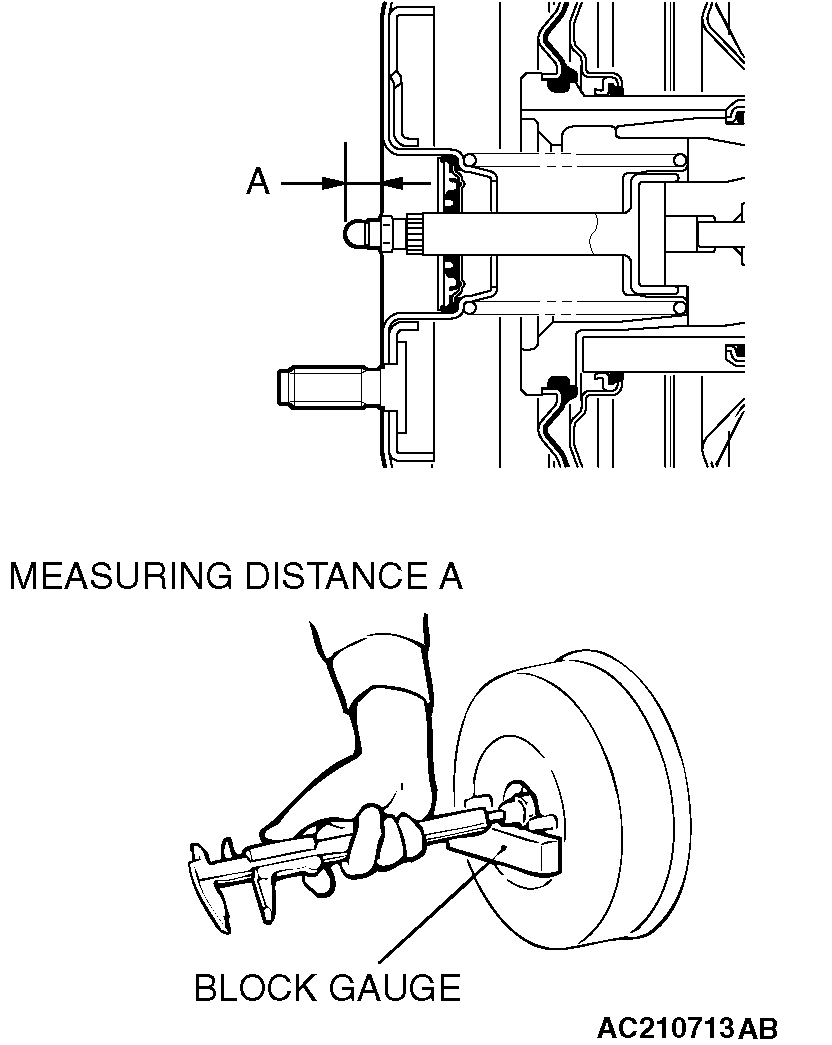

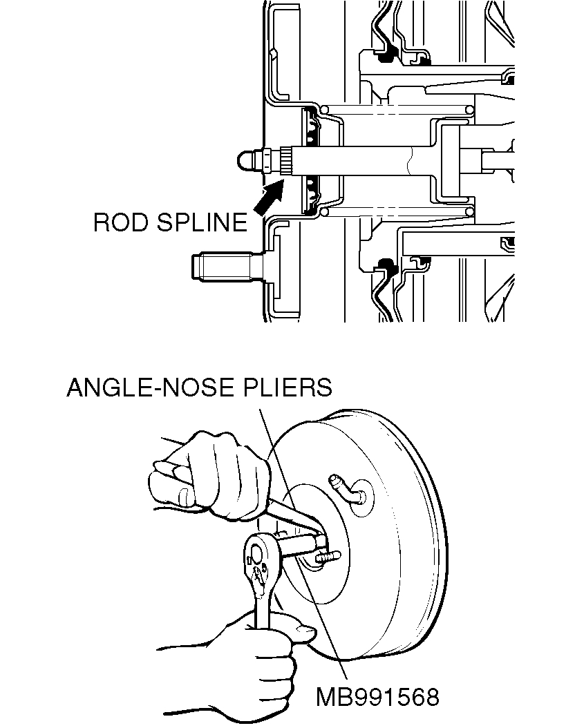

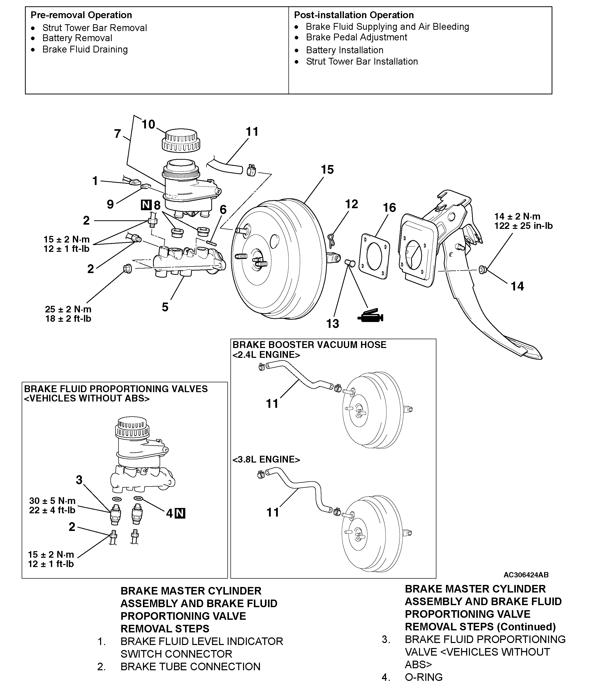

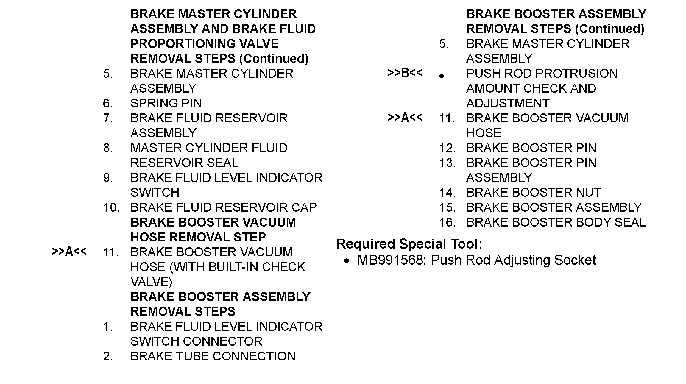

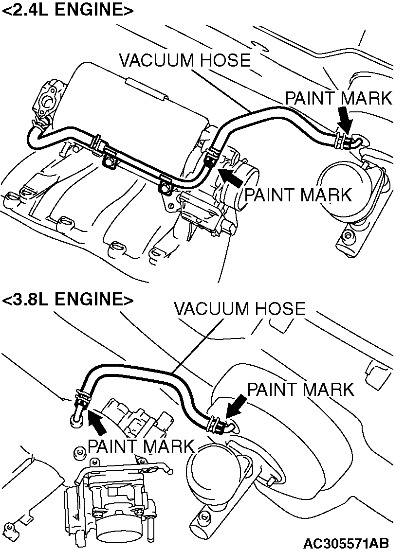

Here are directions specific to your vehicle. The attached pics below correlate with the directions.
______________________________________
2004 Mitsubishi Galant L4-2.4L (4G69)
Removal and Installation
Vehicle Brakes and Traction Control Hydraulic System Brake Master Cylinder Service and Repair Procedures Removal and Installation
REMOVAL AND INSTALLATION
Part 1
pic 1
Part 2
pic 2
MASTER CYLINDER ASSEMBLY AND BRAKE BOOSTER
INSTALLATION SERVICE POINTS
pic 3
