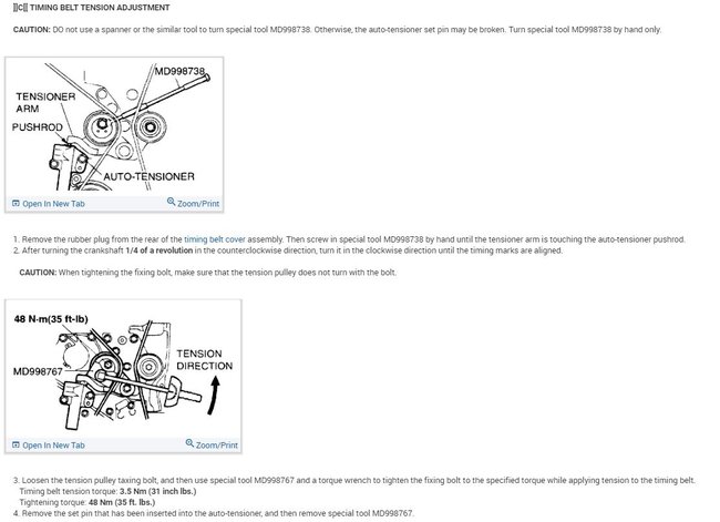

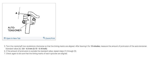

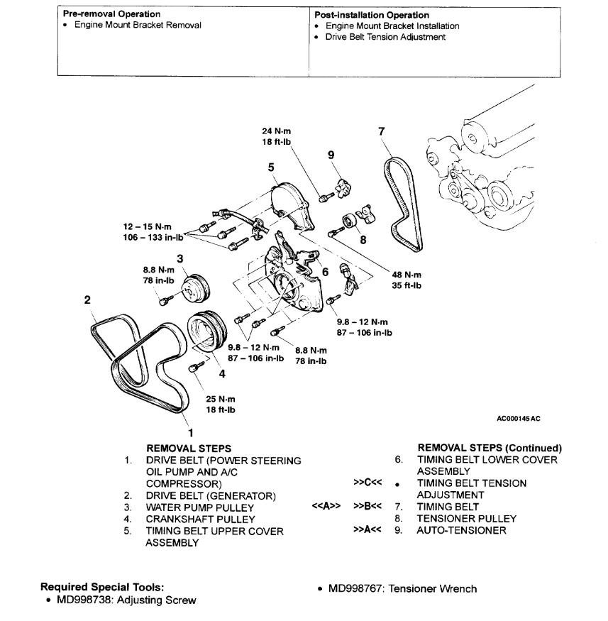

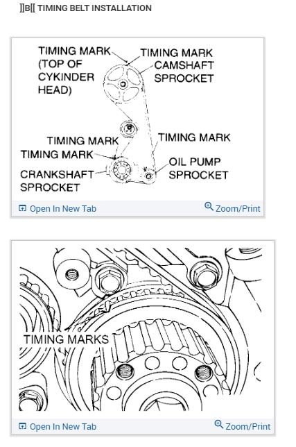

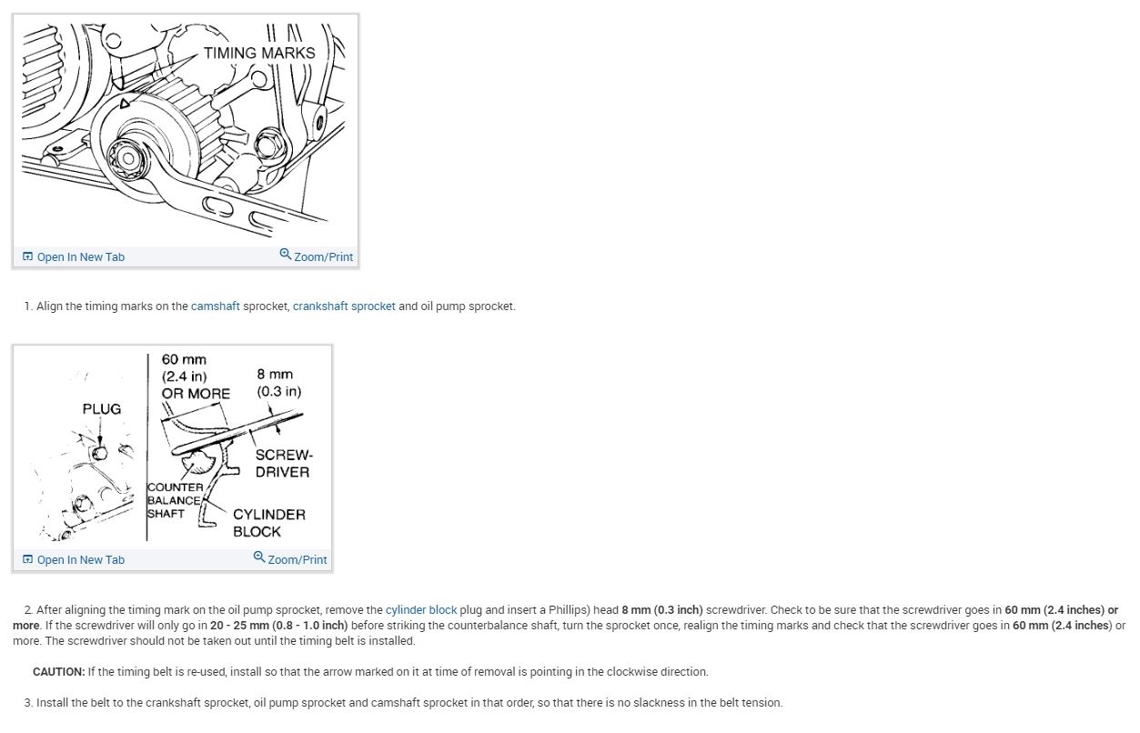

Is it necessary to change the timing belt at a particular mileage interval?
Jan 7, 2009 at 5:13 AM
KHLOW2008
  • 41,814 POSTS
Hi kegelmta,

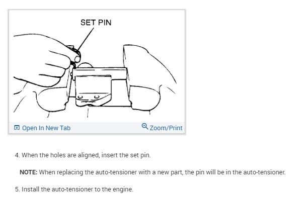

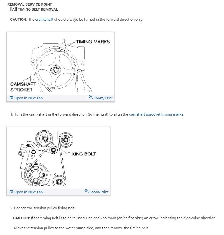

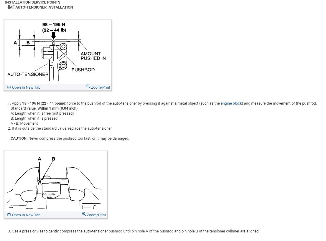

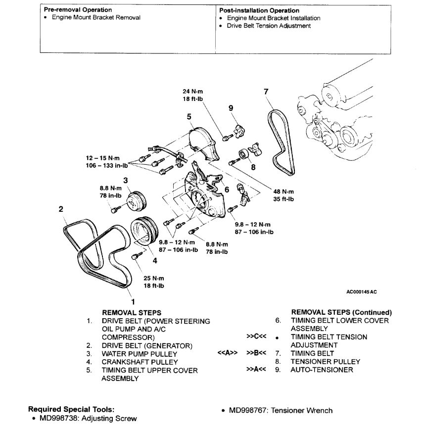

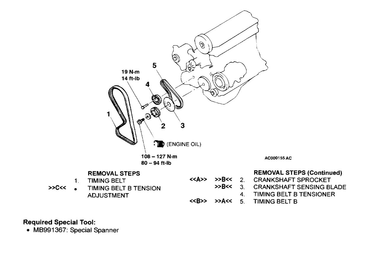

Your post says "timing chain" but your vehicle has a timing belt. The manufacturer recommends inspection of the belt every 30,000 miles and replacement every 60,000
See the diagrams below for replacement procedure
Let us know if you need anything else
