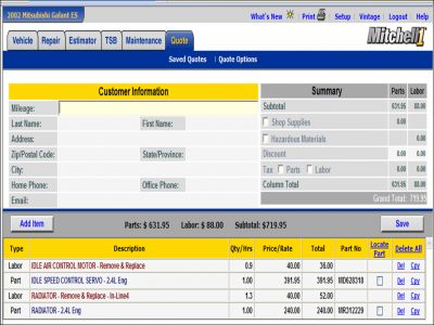

The quote is about what I come up with and that isn’t counting fluids and some other things…..so hang on to them…they are hard to come by.
https://www.2carpros.com/forum/automotive_pictures/248015_Quote_1.jpg

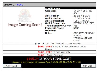

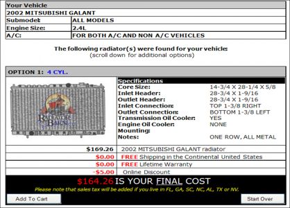

Now I might suggest for the radiator……..instead of going with the one from the dealer have your mechanic check out this site. I have attached two for your car….he just has to do some measuring to get the correct one…..but they are cheaper.
https://www.2carpros.com/forum/automotive_pictures/248015_Radiator1_1.jpg
https://www.2carpros.com/forum/automotive_pictures/248015_Radiator2_1.jpg

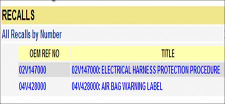

Hello - Oh, one other thing.........you do have a couple of recalls on your car that may apply to you. The dealer may fix these for free. Please contact the dealer service department, give them the VIN number of your car and have them check on these to see if they apply to you.
