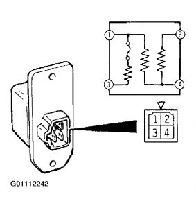

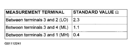

my blower just stopped working, was working one day then i came out the next morning and nothing. is there a fuse i can check to see if it's blown or is it probably jus the motor?
Sep 7, 2008 at 8:52 AM
MERLIN2021
  • CAR REPAIR CONTRIBUTOR
  • 17,250 POSTS
Check the blower motor resistor, its on the a/c plenum and looks like this, test with ohm meter values should be as shown, this or the fuse in the fusebox, or the top relay in the fuse box.
