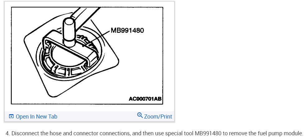

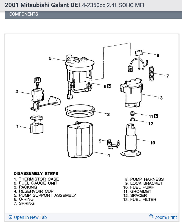

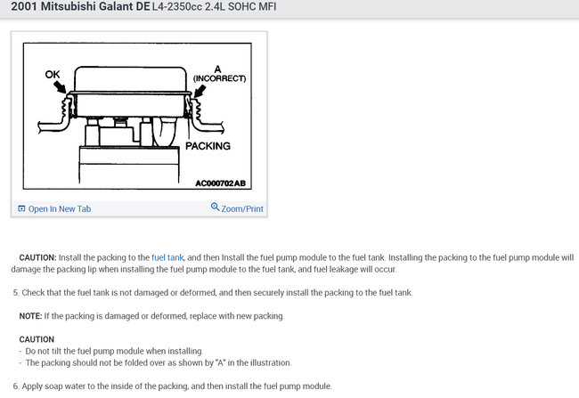

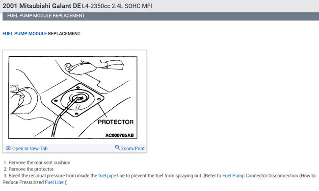

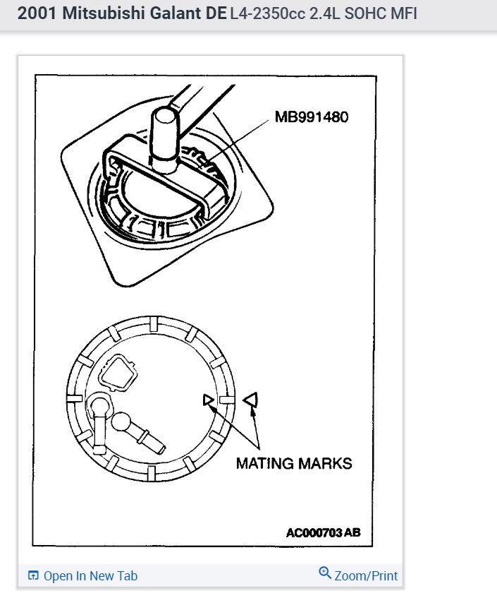

Where is my fuel filter located on my ES model?
Monday, August 16th, 2010 AT 2:32 PM
11 Replies
DOCFIXIT
  • 18,828 POSTS
THe fuel filter for this car is in the fuel tank with the fuel pump here is a guide and diagrams below to show you how to change it out. The pump has a trap door which is nice so you don't need to drop the tank
https://www.2carpros.com/articles/how-to-replace-an-electric-fuel-pump
Cheers
