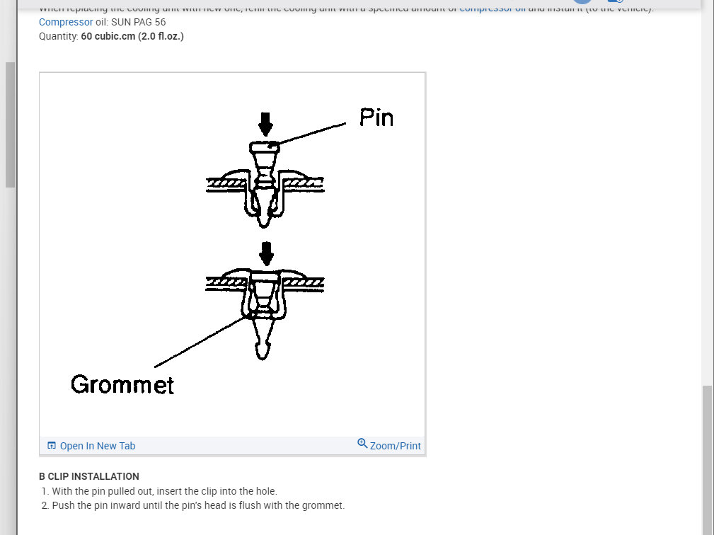

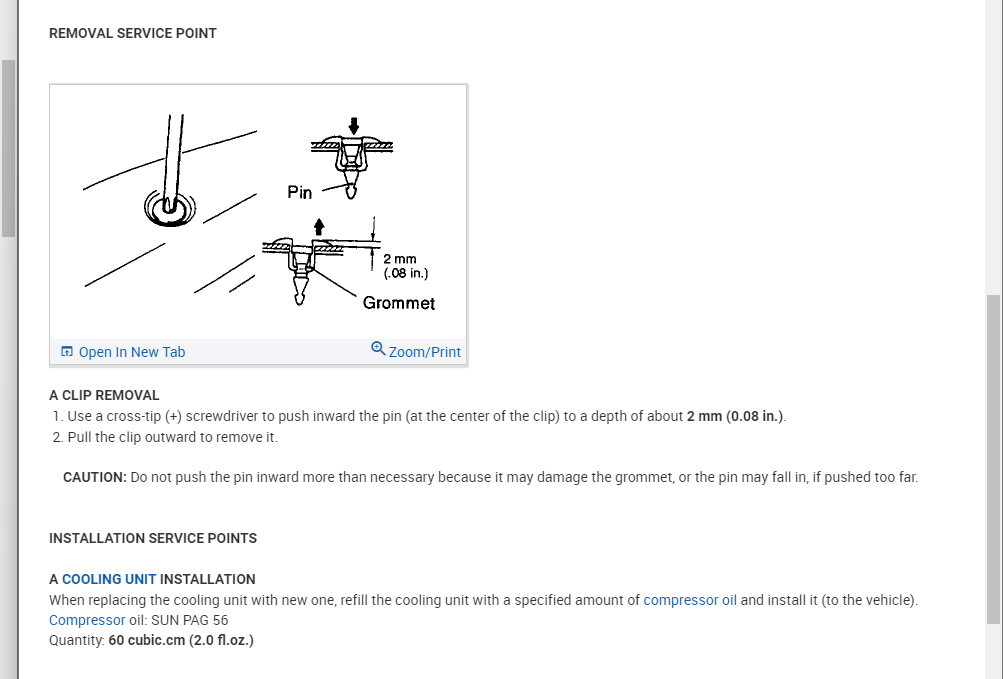

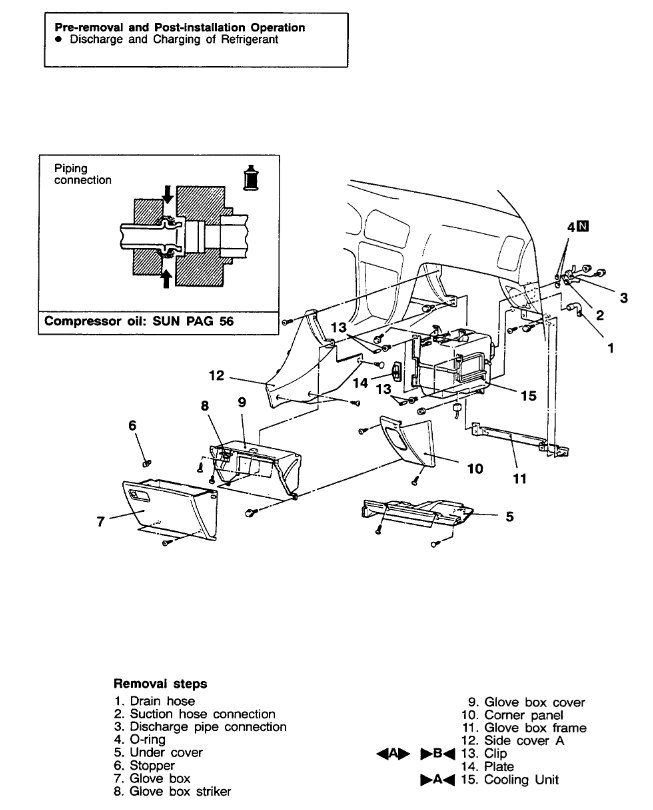

Need replace evaporator core, how is the evaporator case removed? Will the dash board need be removed in order to accomplish this task? How does the donation for your website work?
Sep 10, 2009 at 1:00 PM
To replace the evaporator, you will need to evacuate the A/C system. So, here is a guide that will help with this:
Once that is finished, I am attaching the process below on how to replace this.
Please run through this info and let us know what questions you have.
