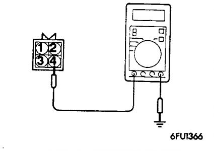

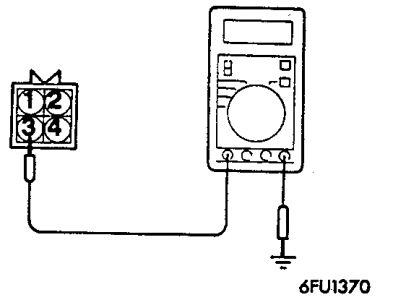

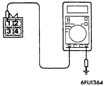

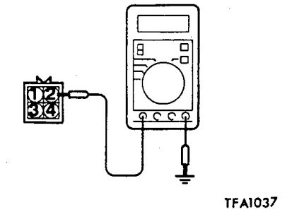

So the car goes into a neutral limp mode type state when switching from third to fourth gear. The only code popping up is P1750.
In detail what does this code mean?
Where exactly is the fault located?
How do I fix it?

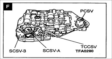

According to the information this is a solenoid assembly malfunction. It could be the converter clutch solenoid, shift control solenoid, pressure control solenoid or engine control module has failed.

Also, which solenoid assembly is it? How do I find out?

Hello, The dip stick I do not have a picture or does it mention the location. You might try checking right under the battery that is where many are. It is really hard to see and check. I have put a test for the converter clutch solenoid.
https://images.2carpros.com/forum/automotive_pictures/248015_Torque_Control_1.jpg
https://images.2carpros.com/forum/automotive_pictures/248015_Torque_Control_2_1.jpg
INSPECTION: 1. Disconnect the Torque Converter Clutch (TCC) solenoid connector. 2. Measure the resistance between the TCC solenoid side connector terminal 2 and the body ground. Standard value: Approximately 13 ohms [at 20 °C (68 °F)] 3. If the resistance is outside the standard value, replace the solenoid valve assembly. I have attached info for the shift solenoid.......use the first pic for the location.
https://images.2carpros.com/forum/automotive_pictures/248015_Shift_1_1.jpg
SHIFT CONTROL SOLENOID VALVE A (SCSV-A) CHECK: 1. Disconnect the SCSV-A connector. 2. Measure the resistance between the SCSV-A side connector terminal 3 and the body ground. Standard value: Approximately 22 ohms [at 20 °C (68 °F)] 3. If the resistance is outside the standard value, replace the solenoid valve assembly.
https://images.2carpros.com/forum/automotive_pictures/248015_Shift_2_1.jpg
SHIFT CONTROL SOLENOID VALVE B (SCSV-B) CHECK : 1. Disconnect the SCSV-B connector. 2. Measure the resistance between the SCSV-B side connector terminal 4 and the body ground. Standard value: Approximately 22 ohms [at 20 °C (68 °F)] 3. If the resistance is outside the standard value, replace the solenoid valve assembly. Use the first picture, this is the test for the pressure solenoid.
https://images.2carpros.com/forum/automotive_pictures/248015_Pressure_1_1.jpg
INSPECTION: 1. Disconnect the Pressure Control Solenoid Valve (PCSV) connector. 2. Measure the resistance between the PCSV side connector terminal 1 and the body ground. Standard value: Approximately 3 ohms [at 20 °C (68 °F)] 3. If the resistance is outside the standard value, replace the solenoid valve assembly.
