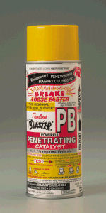

How complicated is the work involved to replace the front brake rotors on a 1996 Mitsubishi Galant

Not at all. Raise vehicle Remove wheel Remove two caliper bolts and remove caliper Remove brake pads Remove two caliper bracket bolts and remove bracket Sometimes the rotor has one or two screw holding them in place. Remove them (if any) If the rotor seems does not want to slide out, spray some PB Blaster around the wheel bolts, and wait 10 minutes
https://images.2carpros.com/forum/automotive_pictures/55316_16pb_3.jpg
Use s soft-faced hammer and tap it
