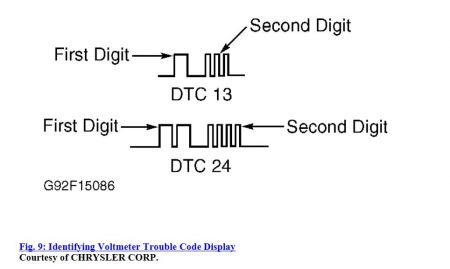

Hi jolor, Thank you for the donaton. For Mitsubishi vehicles, quite a number of scanners cannot read the codes, especially the transmission codes and you can try using a voltmeter or a LED lamp. Voltmeter Method 1. Diagnostic connector is located to the right side of steering wheel under the instrument panel. Install voltmeter between ground terminal No. 4 or No. 5 and diagnostic output terminal No. 6. See Fig. 20 .
https://images.2carpros.com/forum/automotive_pictures/192750_DLC93Galant_1.jpg
2. Turn ignition on. Note fluctuations of voltmeter needle to indicate DTC. The first fluctuation indicates first digit of DTC. Following fluctuations indicate the second digit of DTC. See Fig. 9 . Record DTC's in order displayed.
https://images.2carpros.com/forum/automotive_pictures/192750_CodeVoltmeter93Galant_1.jpg
Get the code and we shall see what the problem is.
