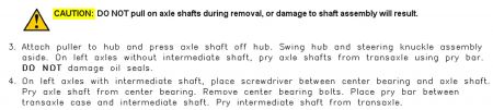

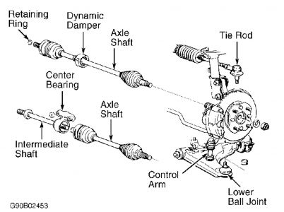

The transmission went out in my car...I bought another used transmission but my problem is the CV joint wont come out...Ive tried everything that has been suggested to me...I used a come a long and it broke so I went and bought a 4 ton and it still wont come out even with a lot of pressure applied...It was also suggeted that I use a large pry bar along with the pressure and still nothing...If anyone can give me some advise that might work I would sure apperciate it...

Do you have an intermediate shaft on that? I wouldn't re-use that axle if you've been yanking on it like you described. This is out of mitchell if it helps:
https://images.2carpros.com/forum/automotive_pictures/30961_g1_1.jpg
https://images.2carpros.com/forum/automotive_pictures/30961_g2_1.jpg
