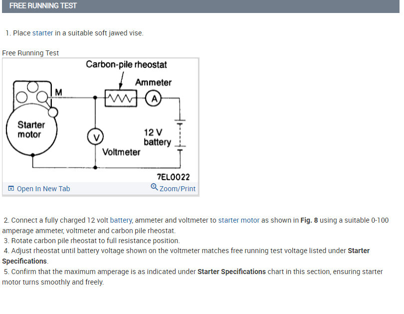

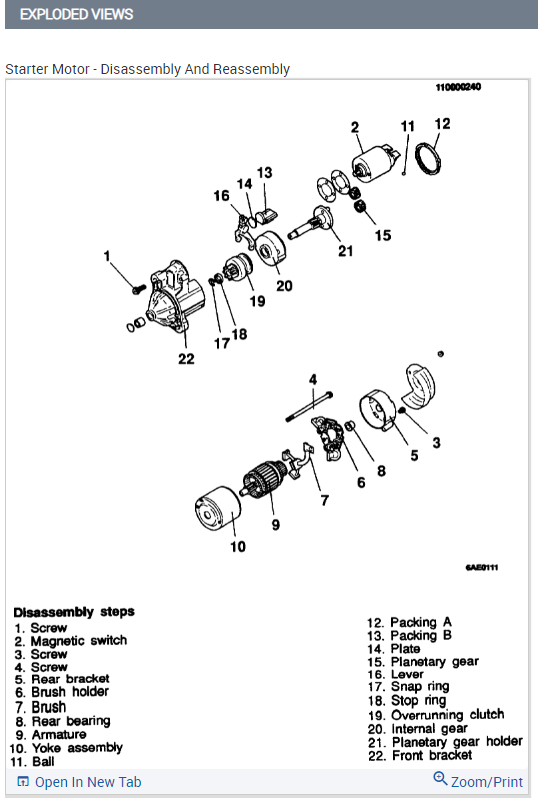

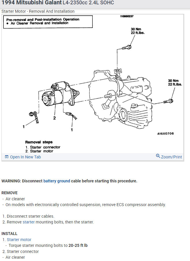

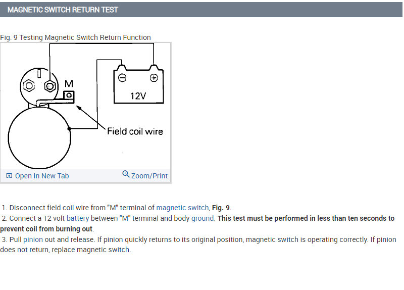

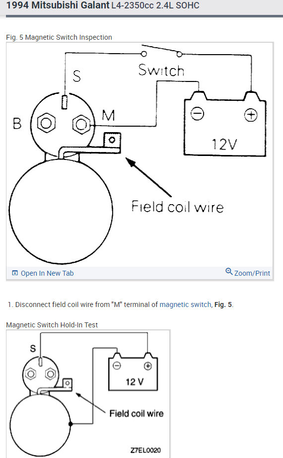

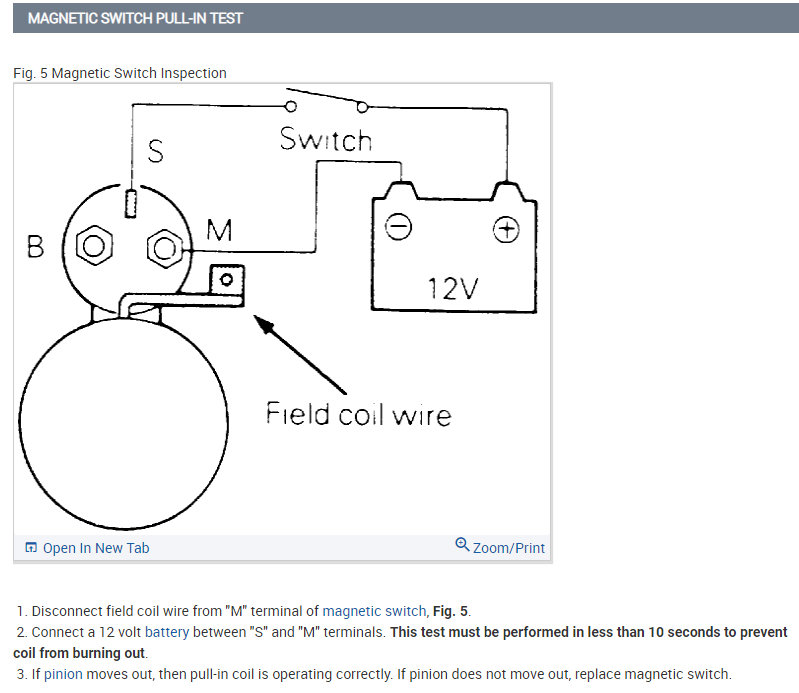

Where is the starter and how do I replace it?
Jul 27, 2009 at 1:25 PM
SQM
  • 6,383 POSTS
See attached for the starter replacement and testing procedure.
You might find this article helpful:
Let me know if you have any questions.
