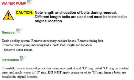

1994 Mitsubishi Galant replace water pump
1994 MITSUBISHI GALANT
188,000 MILES • 4 CYL • FWD • AUTOMATIC
ALFIX88
How do you replace the water pump on this car and should i replace the timing belts. Thank You

https://images.2carpros.com/forum/automotive_pictures/261618_Noname_2169.jpg
