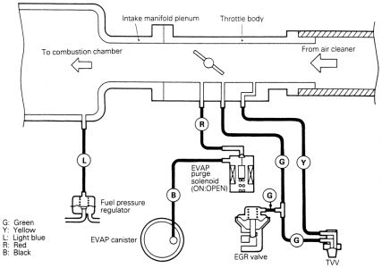

I have a vaccum hose coming from some type of module on the Passenger side corner under the hood. The vaccume line is connected to the module but it has come lose at the other end and I cannot locate where it connects to. I also have not been able to locate a vaccum diagram anywhere online to view.
Can you tell me where that line is suppose to connect or the routing for it or provide me a exploded view of the vaccum routing diagram.

This is for a 2.0L SOHC engine in the 1990-1993 Mitsubishi Galant. If this is incorrect engine size, please be more specific.
https://images.2carpros.com/forum/automotive_pictures/261618_0900c152800af9d4_3.jpg
