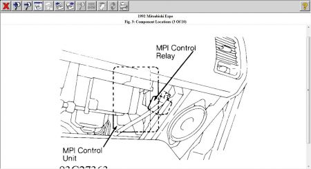

No fuel getting to rail. changed filter and pump? Cannot locate a labeled relay where is it?

Do you hear the fuel pump come on when you turn key to run? The MPI control relay is located behind right side of dash
https://images.2carpros.com/forum/automotive_pictures/12900_mpi_1.jpg
It powers the fuel pump.
