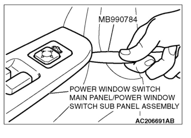

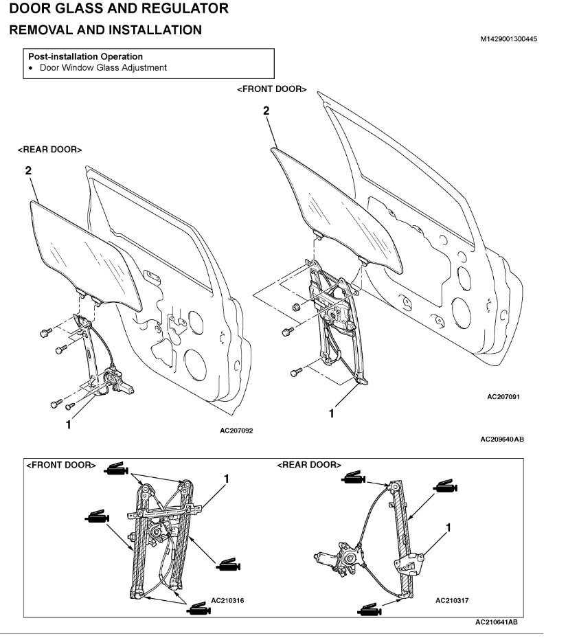

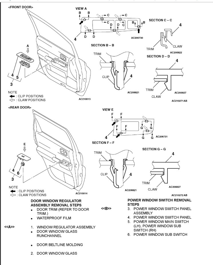

How do I change out the regulator for the rear driver side window?
Aug 22, 2010 at 11:17 AM
BLUELIGHTNIN6
  • 16,542 POSTS
First you will need to remove the door panel here are two guides and diagrams below to help you get the job done.
https://www.2carpros.com/articles/door-panel-removal
and
https://www.2carpros.com/articles/how-to-check-and-replace-a-electric-power-window-motor
Note the following during door panel removal:
Insert a flat-tipped screwdriver into the notch on the front door trim assembly and the rear door trim assembly until the screwdriver tip touches the clip. Disengage the clip to remove the front door trim assembly and rear door trim assembly.
