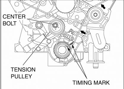

I cannot find a repair manual for this car, and can't figure out how to release the tension on the timing belt to remove and replace it

Hello and thanks for donating You need to turn the timing belt tensioner counterclockwise to release the timing belt's tension.
https://images.2carpros.com/forum/automotive_pictures/261618_Noname_2134.jpg
