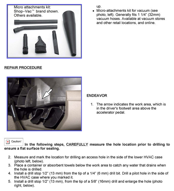

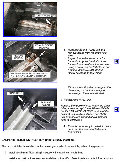

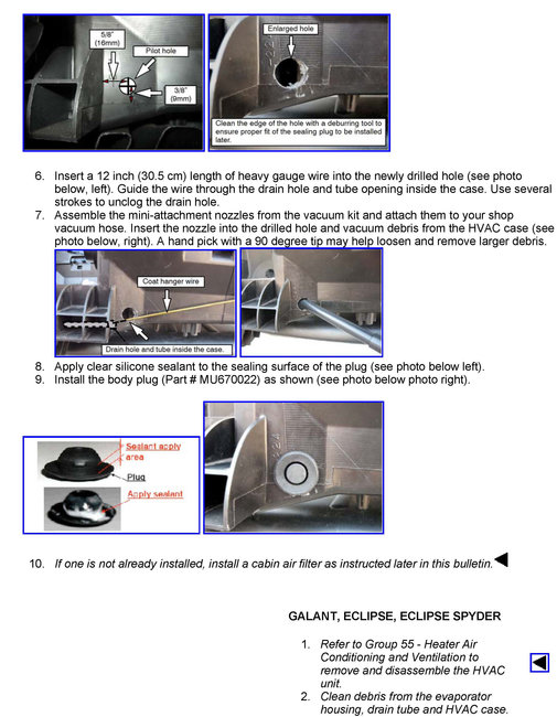

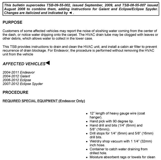

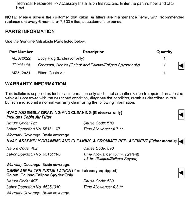

The TSB listed above has been superseded. Here is the most updated one that explains how to fix the issue. The attached pics correlate with the directions.
_____________________________________
2004 Mitsubishi Truck Endeavor V6-3.8L SOHC
A/C - Sloshing Noise From Dash/Water Dripping Onto Carpet
Vehicle Maintenance Filters A/C - Sloshing Noise From Dash/Water Dripping Onto Carpet
A/C - SLOSHING NOISE FROM DASH/WATER DRIPPING ONTO CARPET
No: TSB-12-55-002
DATE: April, 2012
MODEL: See Below
pic 1
pic 2
pic 3
pic 4
pic 5
SUBJECT:
WATER SLOSHING NOISE OR WATER LEAK FROM
HVAC CASE - REVISED
