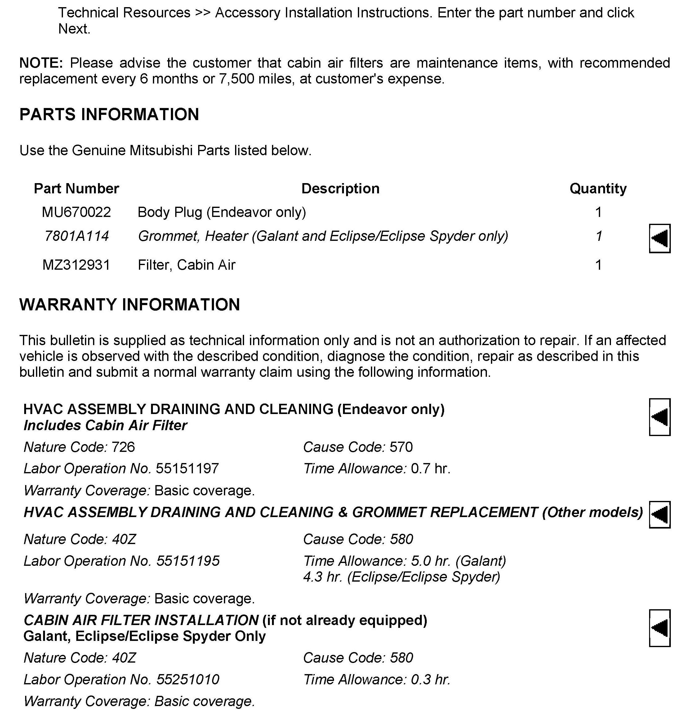

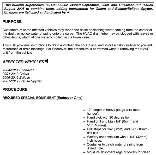

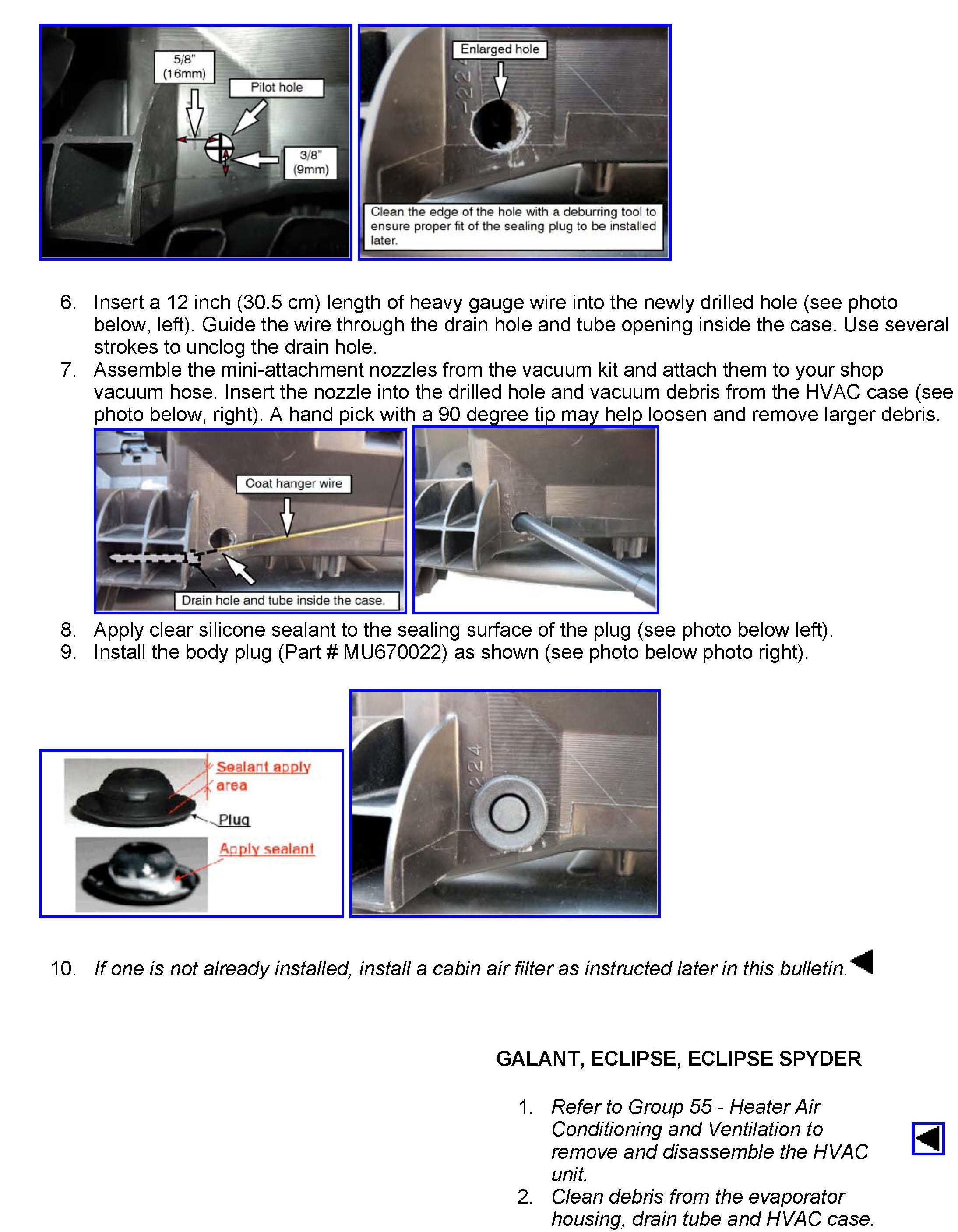

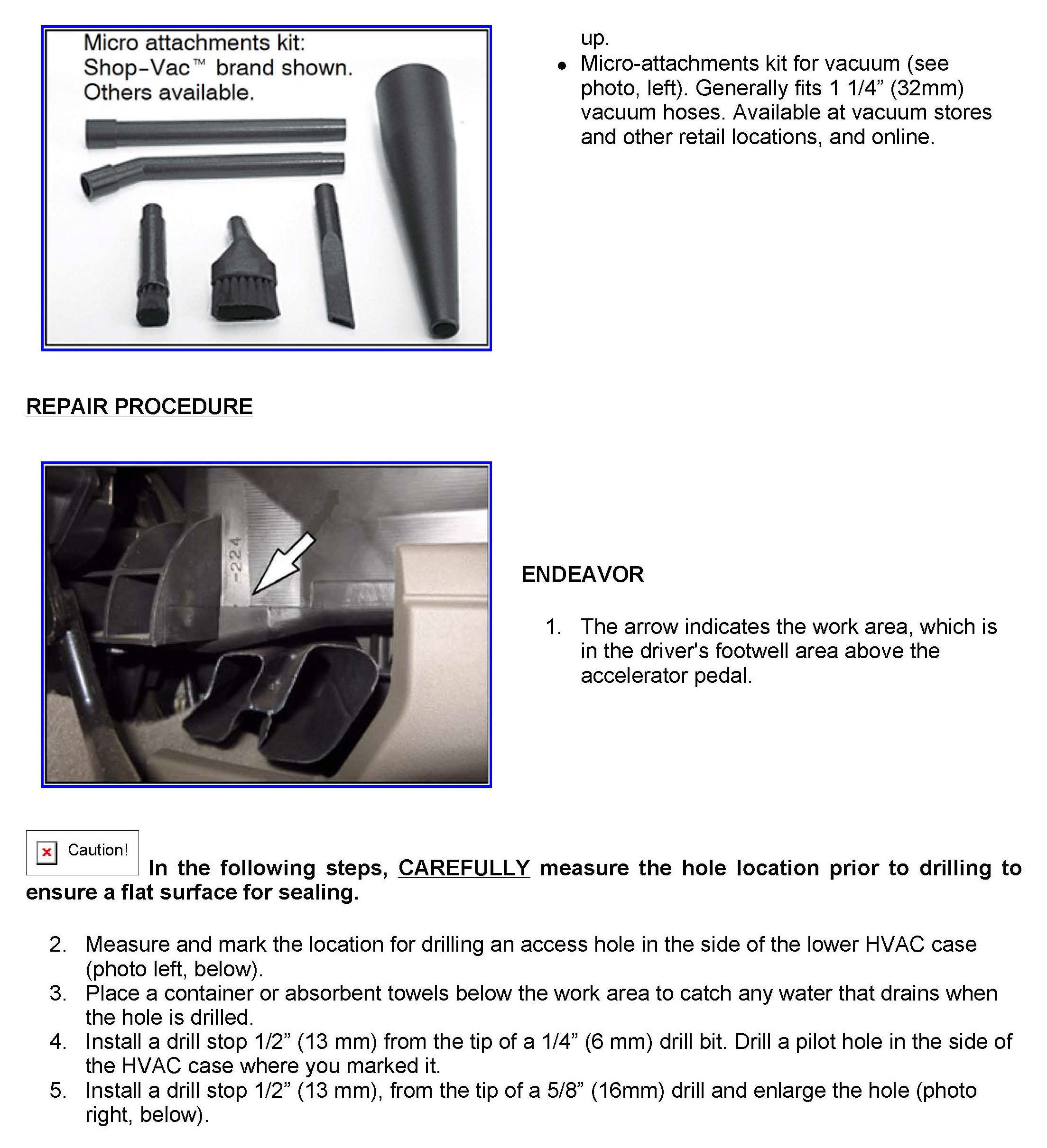

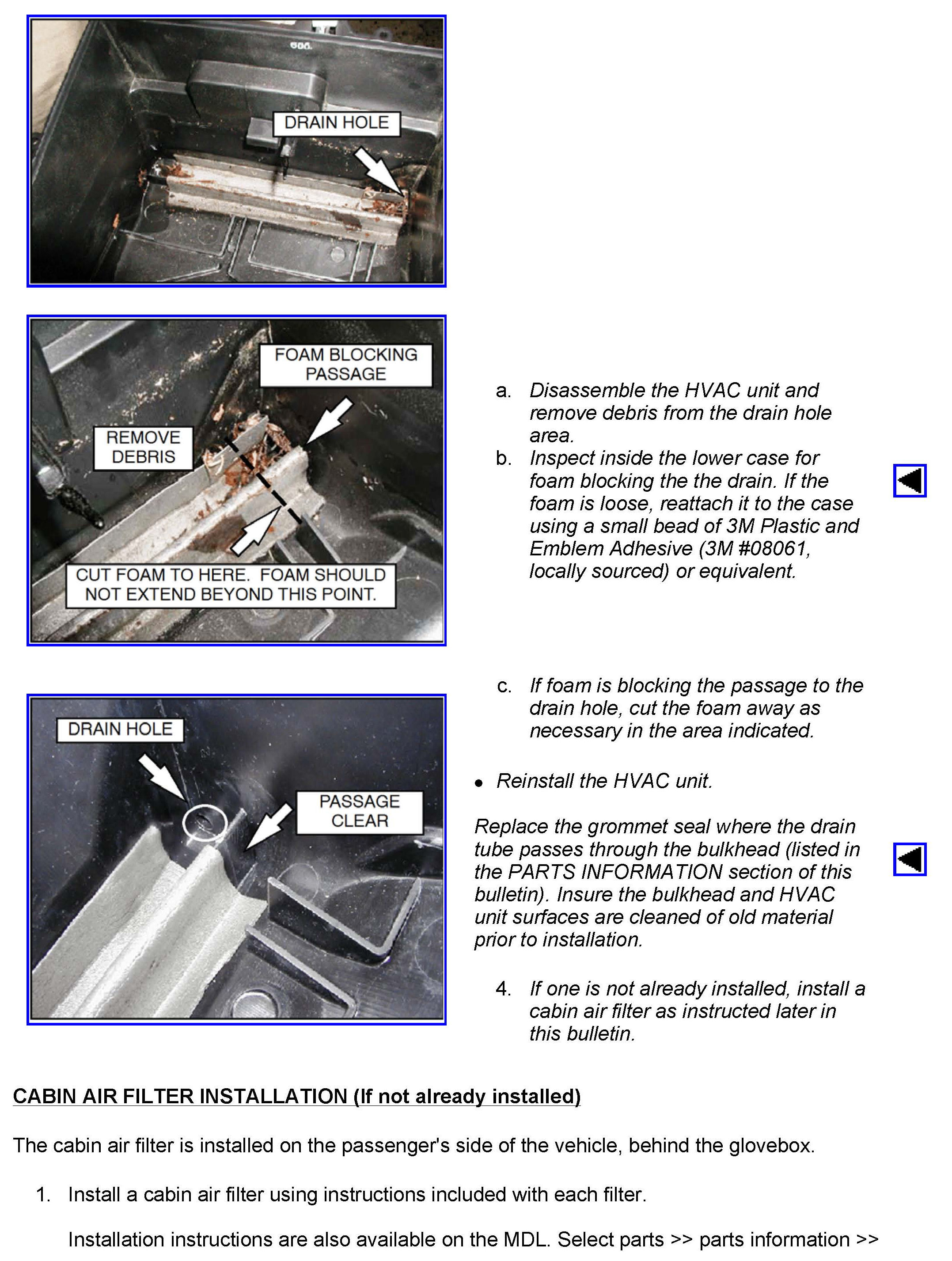

There are YouTube videos that show the placement, but look up TSB 09 55 002, which I found more helpful. I'll give a link, but in case it becomes invalid you'll at least know what to search. You can attempt to unclog the drain from underneath your Endeavor, but as you found the clog will just come back. If you follow the TSB recommendations you can at least unclog it relatively easily from inside your vehicle. (The actual fix is creating a new drain hole altogether, and blocking the old drain to prevent future leaks from there.)
Or, you can attempt to remember to unclog your current drain every few weeks. And when you don't you'll have a leak.
http://ww2.justanswer.com/uploads/superbovine/2010-07-04_012815_tsb09550021.pdf

The TSB listed above has been superseded. Here is the most updated one that explains how to fix the issue. The attached pics correlate with the directions.

2004 Mitsubishi Truck Endeavor V6-3.8L SOHC
A/C - Sloshing Noise From Dash/Water Dripping Onto Carpet
Vehicle Maintenance Filters A/C - Sloshing Noise From Dash/Water Dripping Onto Carpet
A/C - SLOSHING NOISE FROM DASH/WATER DRIPPING ONTO CARPET
No: TSB-12-55-002
DATE: April, 2012
MODEL: See Below
pic 1
pic 2
pic 3
pic 4
pic 5
