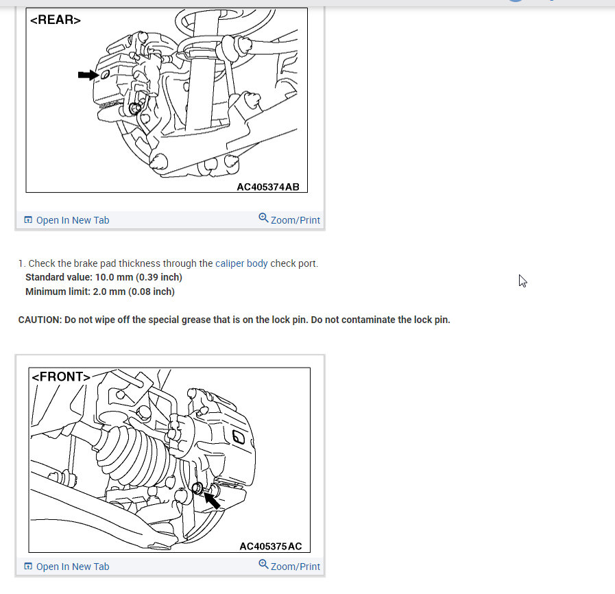

This is normally due to a fluid leak but if the pedal is not going all the way to the floor then it is most likely just worn brake pads. Clearly if you had a leak and the pedal is dropping then you would have lost brakes by now. Here is a guide that will help with this:
https://www.2carpros.com/articles/brake-pedal-goes-to-the-floor

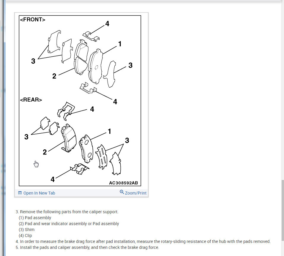

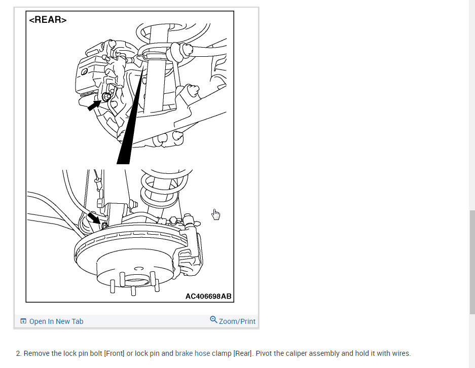

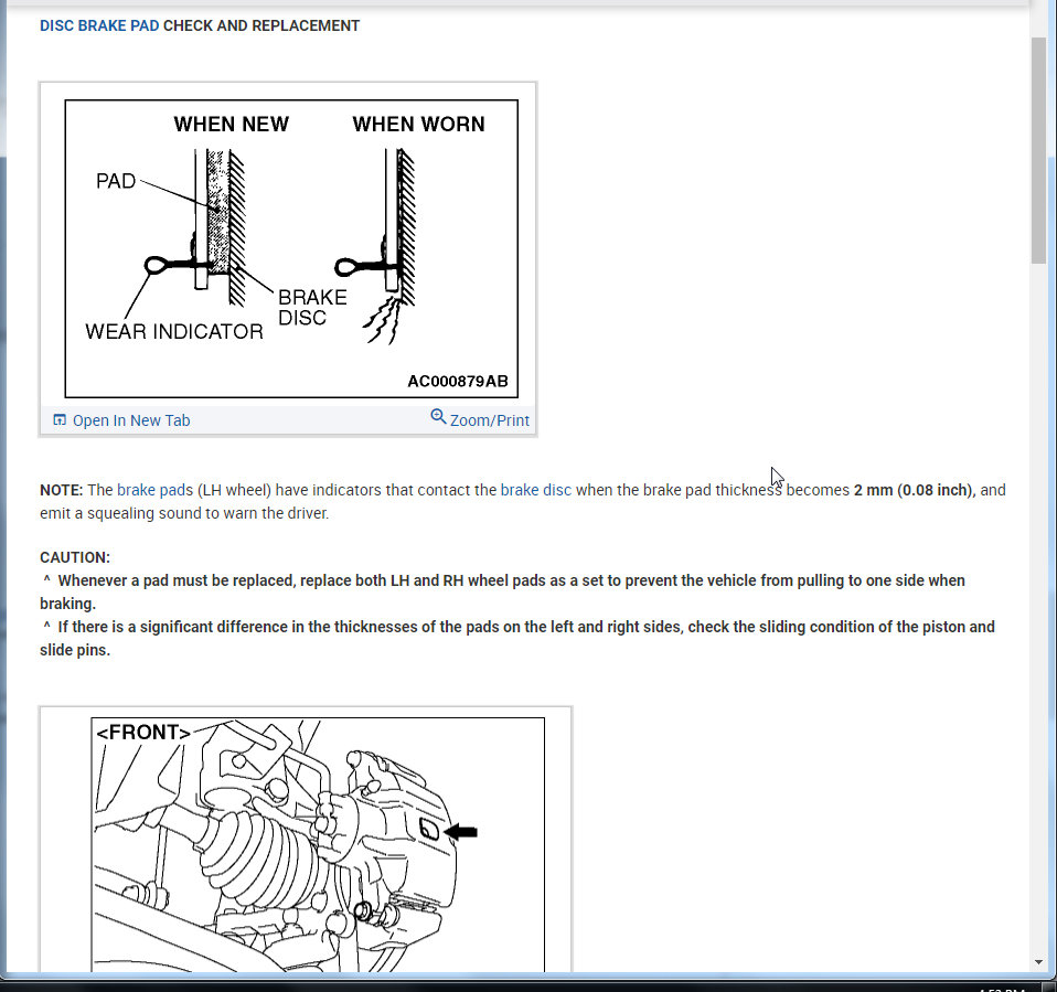

However, I suspect you just need to replace the pads so here are guides to help with this:
https://www.2carpros.com/articles/how-to-replace-rear-brake-pads-and-rotors
Below you will find the process from the manual on how to replace the pads and rotors on this vehicle. Please let us know if you have other questions. Thanks
