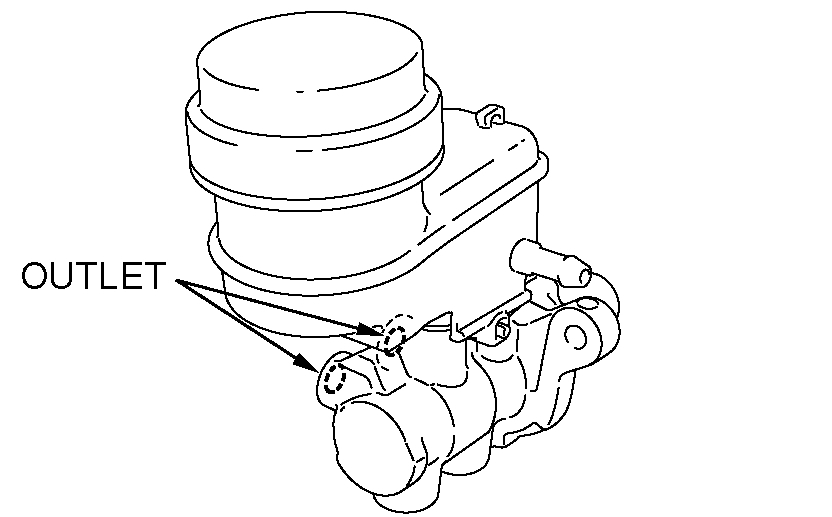

MASTER CYLINDER BLEEDING
The master cylinder used has no check valve, so if bleeding is carried out by the following procedure, bleeding of air from the brake pipeline will become easier. (When brake fluid is not contained in the master cylinder).
1. Fill the reserve tank with brake fluid.
2. Keep the brake pedal depressed.
pic 1
3. Have another person cover the master cylinder outlet with a finger.
4. With the outlet still closed, release the brake pedal.
5. Repeat steps 2 - 4 three or four times to fill the inside of the master cylinder with brake fluid.

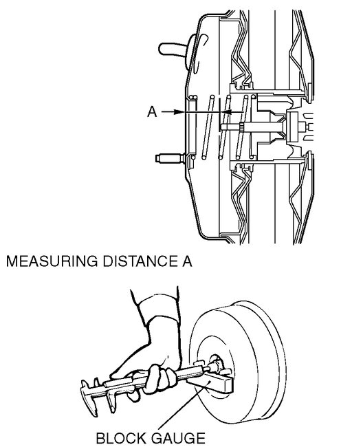

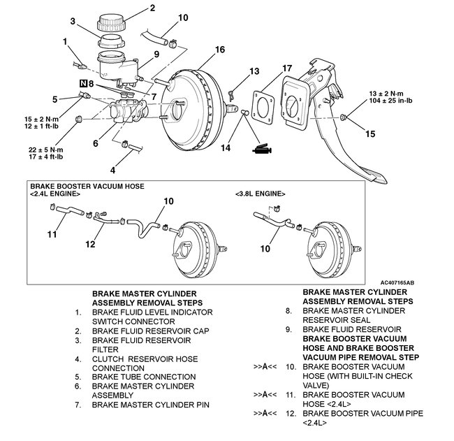

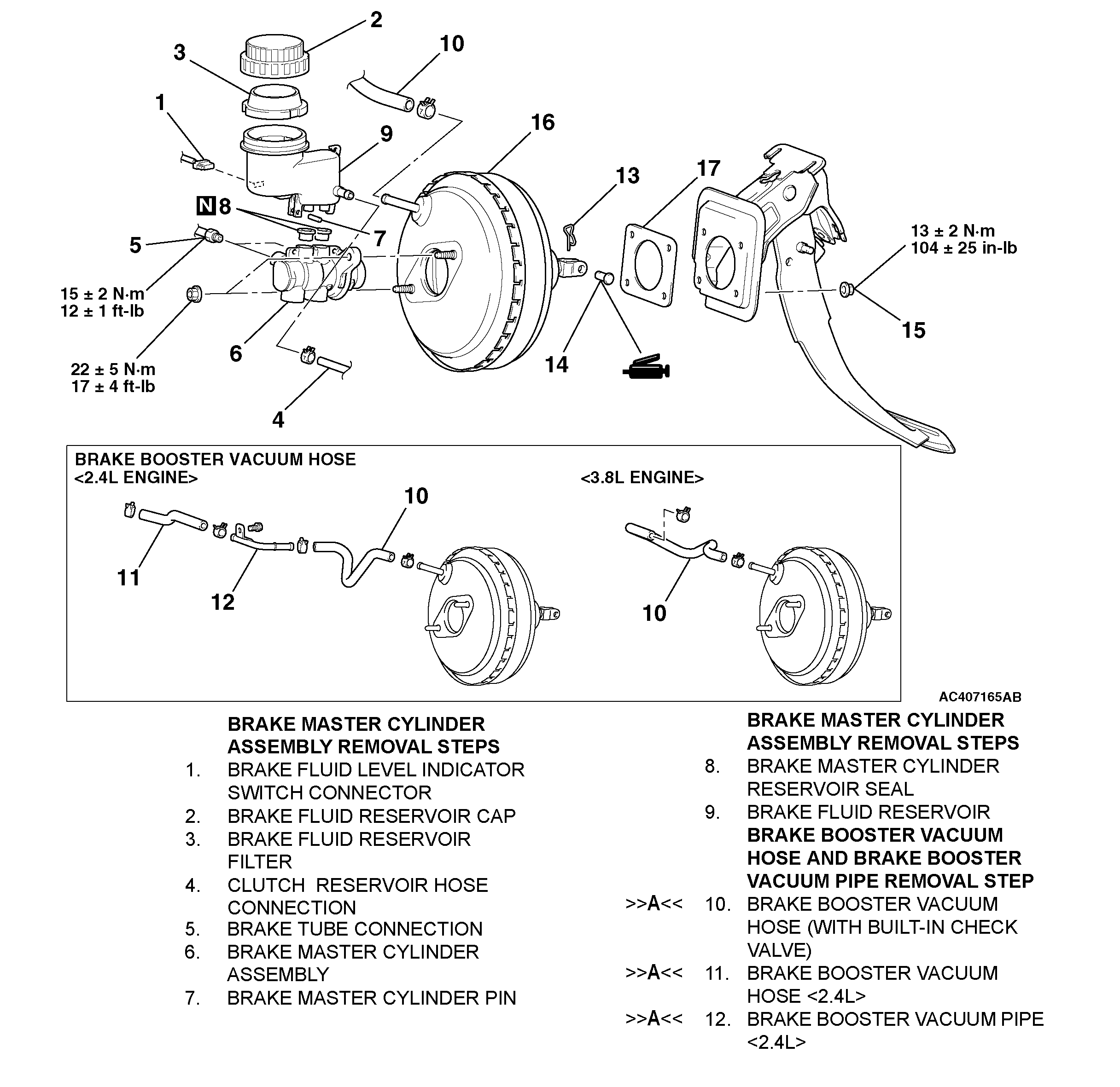

MASTER CYLINDER ASSEMBLY AND BRAKE BOOSTER
REMOVAL AND INSTALLATION

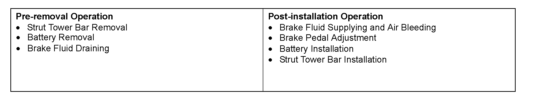

Pre-removal & Post-installation Operation

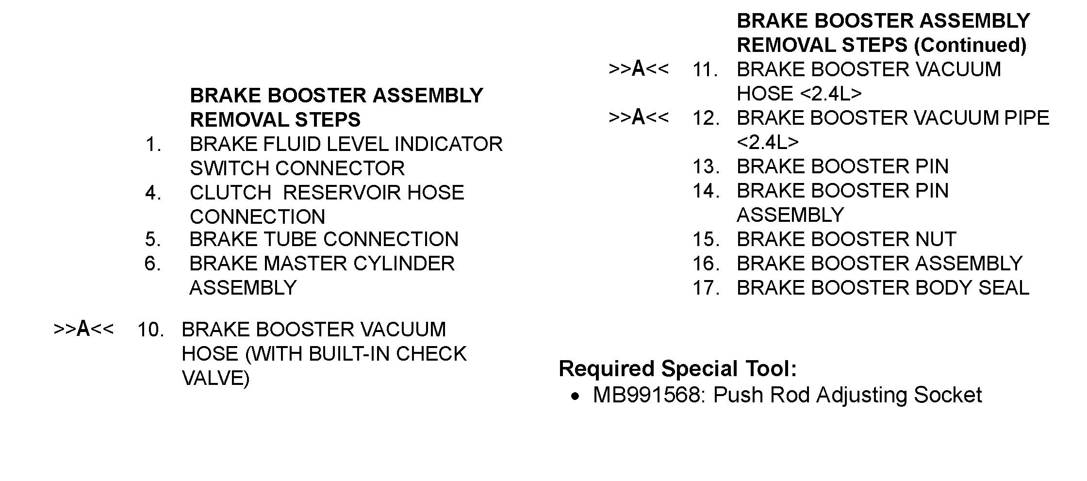

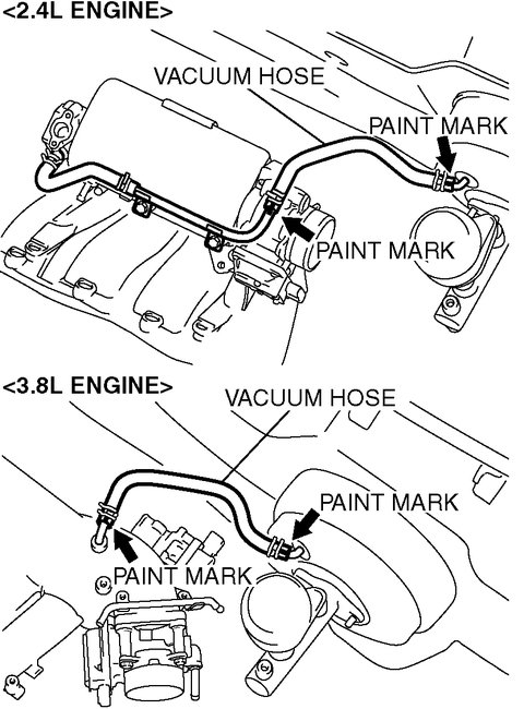

pic 2
Removal Steps 1-12

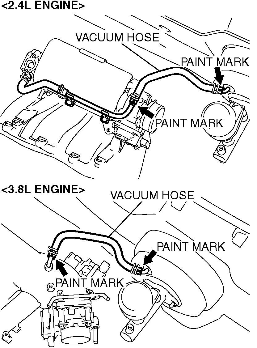

pic 3

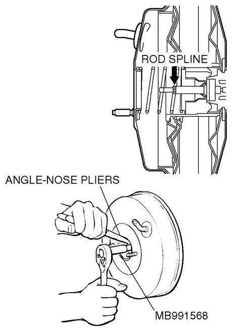

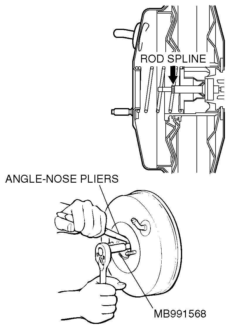

Removal Steps 1-17 & Required Special Tool

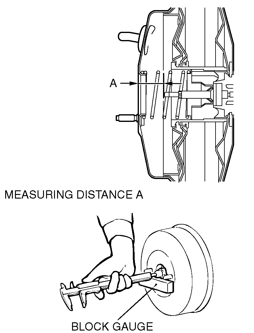

pic 4
INSTALLATION SERVICE POINTS
>>AB
