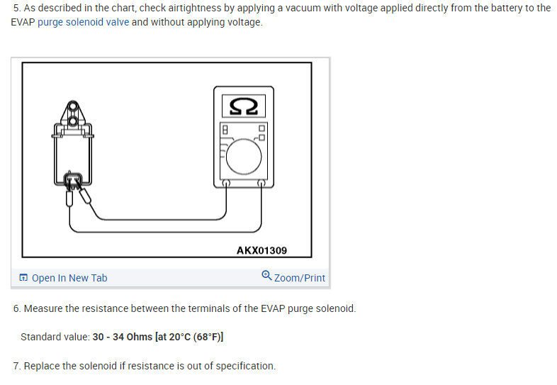

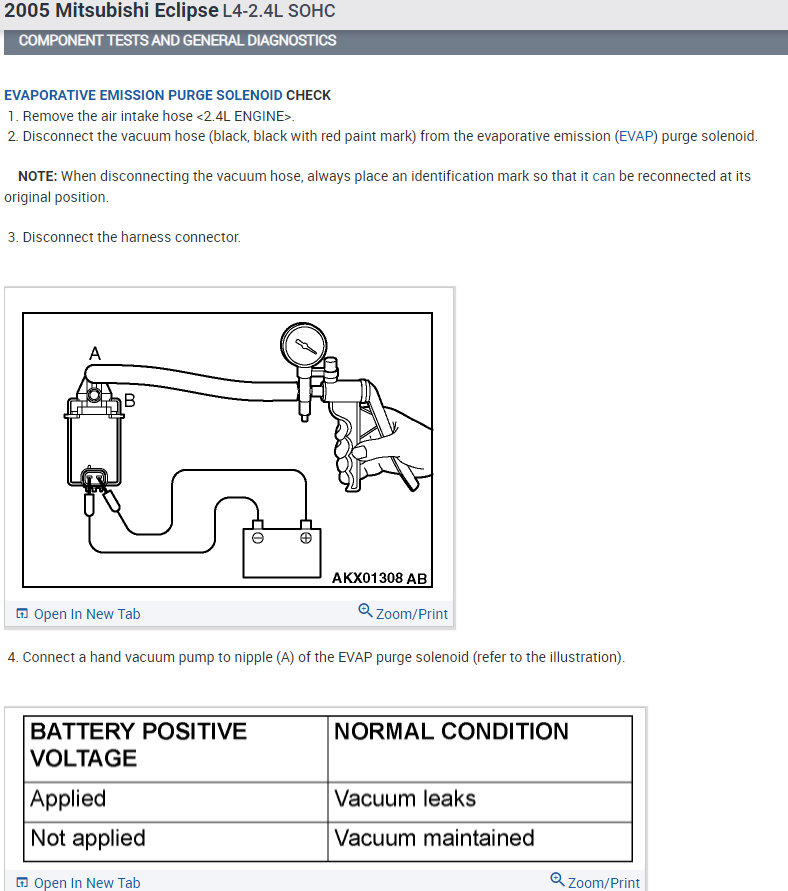

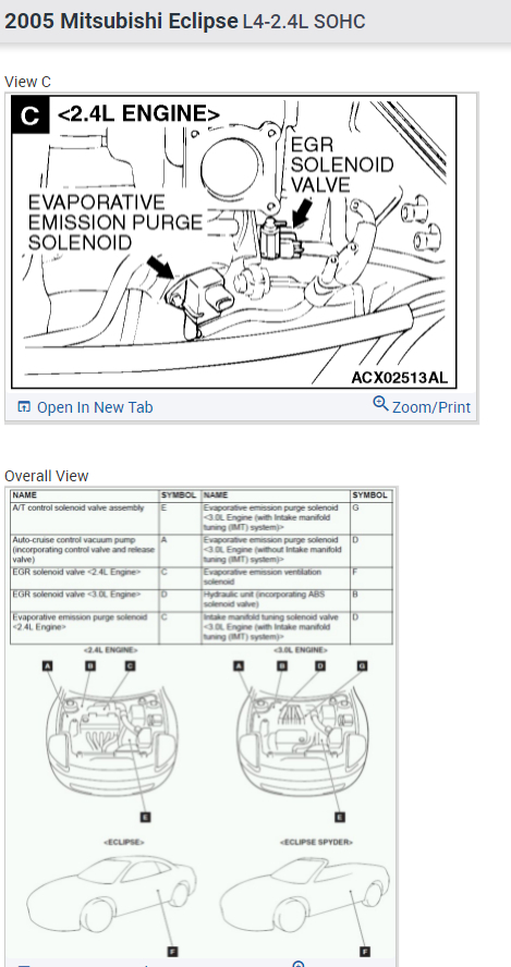

It sounds like you might have a faulty EVAP purge solenoid. Due to that the pressure inside the tank is higher than it should be. That's why you are having difficult time filling up the gas tank.
You can test to see if the solenoid is working as intended.
Hook up a vacuum gauge to the port and have 12V power supply to the connector.
When you apply battery power you should have a leak and when the power gets turned off there should be no leak.

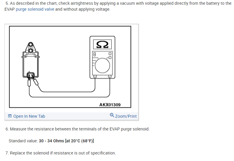

Also the resistance between the two terminals should be 30-34 Ohms.
This can also be triggered by a clogged charcoal canister.
