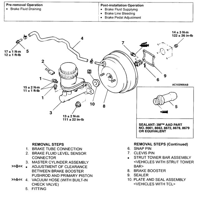

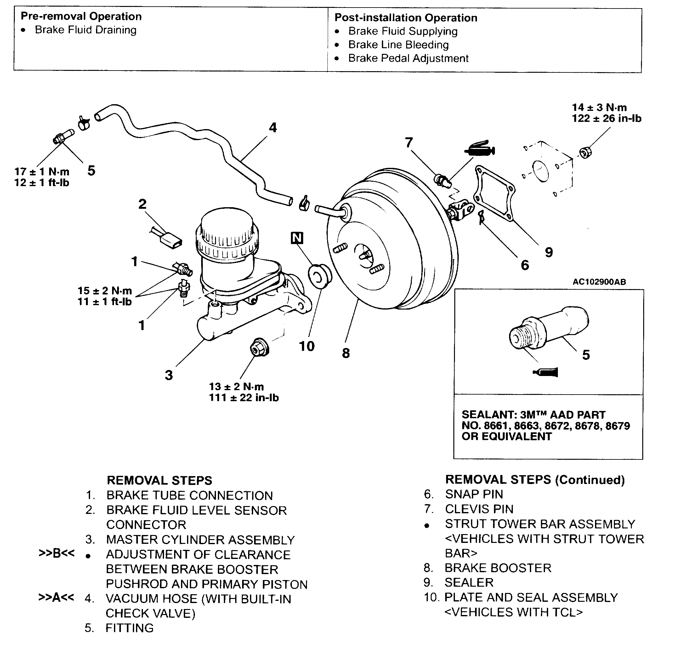

Replacing a power brake booster takes a little time, but really isn't too hard to do. I recommend getting a lifetime replacement part so you never have to pay for a new one in the future.
Here are the directions specific to your vehicle. The pics attached below correlate with the directions.

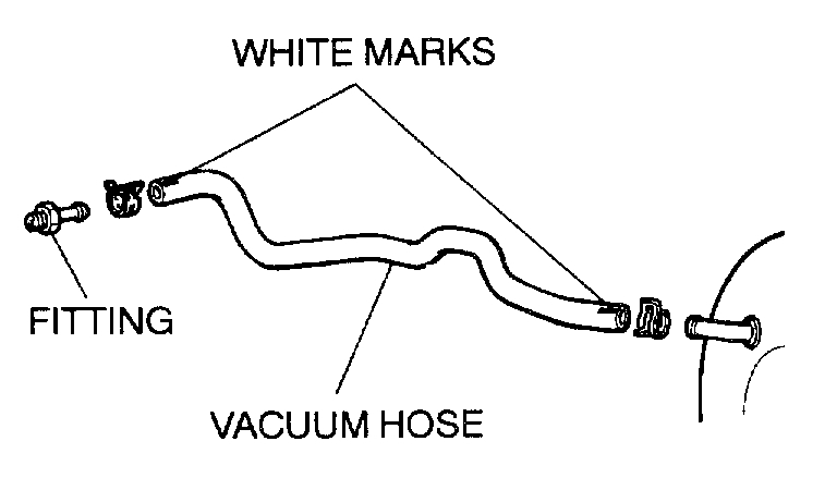

pic 1
REMOVAL AND INSTALLATION
CAUTION: Do not remove the check valve from the vacuum hose. If the check valve is defective, replace it together with the vacuum hose.

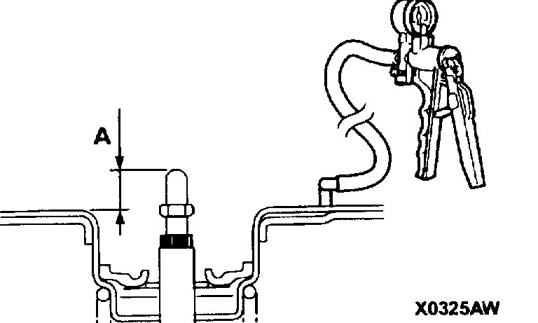

INSTALLATION SERVICE POINTS
>>AB
